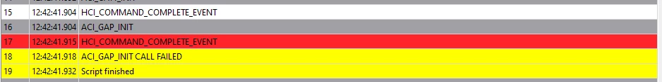

Dams
October 31, 2024
I have the same behavior with the BlueNRG GUI 4.7.1 and a board IDB008V1M at the ACI_GAP_INIT.
The script OTA_Central.py works with my board if the stack of BlueNRG-2 is 2.1c but not with stack 2.1f.
In the repository of the BlueNRG GUI 4.7.1, the DTM_UART.hex found set the stack 2.1f.
How can I do to have the script working with stack 2.1f ?
