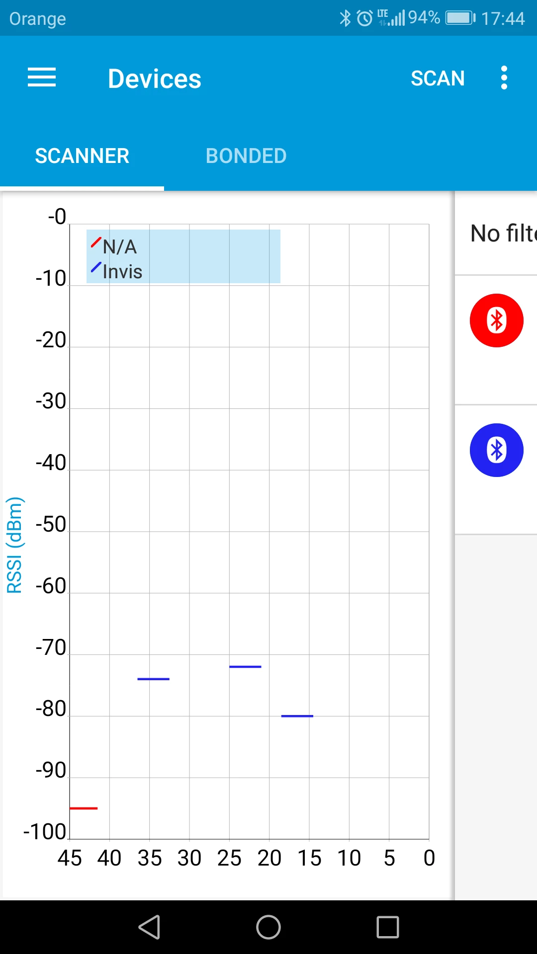

I'm having trouble with advertising: it seems that after some time, the module stops advertising.
The actual time after the issue appears seems to be grossly related to the Advertising_Interval_Min & Advertising_Interval_Max values. The lower the values, the shorter the time the issue appears.
Values such as 0x800 and 0x900 (default) seems to encounter the issues after days but values such as 0x20 and 0x30 encounter the issue after minutes.
When the advertisement stops, it is still possible to connect to the module, using it's address.

I have the same problem. Here is a screenshot from Android phone. The dark blue line is BlueNRG-MS visibility. There were no connections made. It's not a problem with visibility after disconnection.
