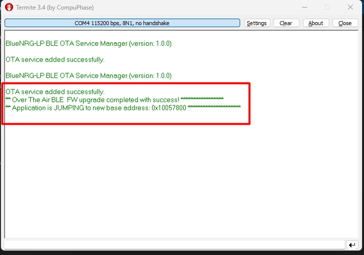

Bluenrg-lp OTA Service Manager - error when starting new application
  • November 13, 2024
  • 0 replies
  • 618 views
I'm trying to perform a remote firmware update, with the bluenrg-lp ota service manager, I record the manager image at the base address 0x10040000 in sequence, i can perform the update without errors via ota, but when restarting the application, i have the debug message that it is jumping to the new image loaded at address 0x10057800, as if everything was fine until then, but after that i have no response from my application, simply it gets stuck, could you help me with this problem?
