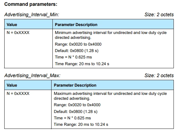

    Hi @jbie​ ,
    Agree maximum is not exactly 10sec (this is a common language we used).
    Maximum allowed according to BT core spec is 10.24sec for the legacy advertising you are using.
    See : BT core spec 5.2 - §7.8.5 : LE Set Advertising Parameters command
    The 10,485 value you are mentioning refer to the "extended advertising".
    Coming back to your point, this maximum of 10.24sec is indeed supported by BlueNRG-LP stack in accordance with BT core spec.
    You can test ADV_interval = 16384 (10.24sec = 16384*0.625)
    You can check our "Beacon example" from SDK for more details.

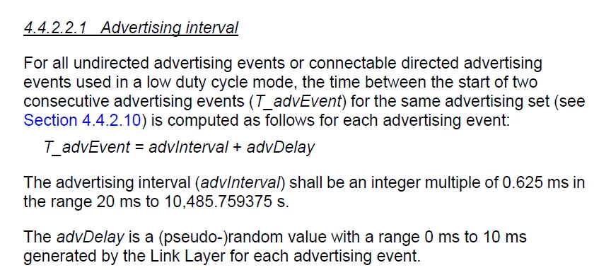

    There is an interpretation error from ST. The Core spec 5.2 says 10485 seconds and not 10 seconds.
    Regards,
    Jean
