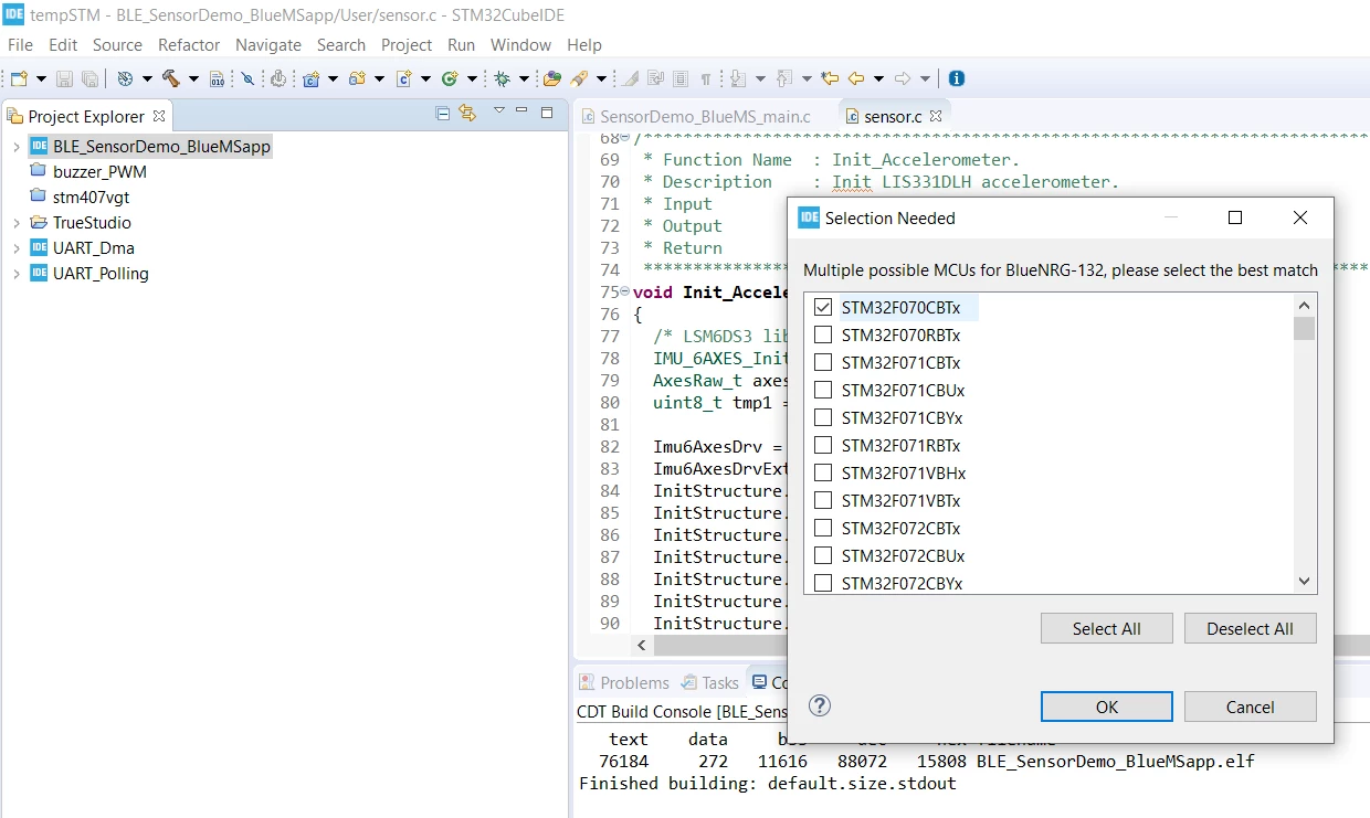

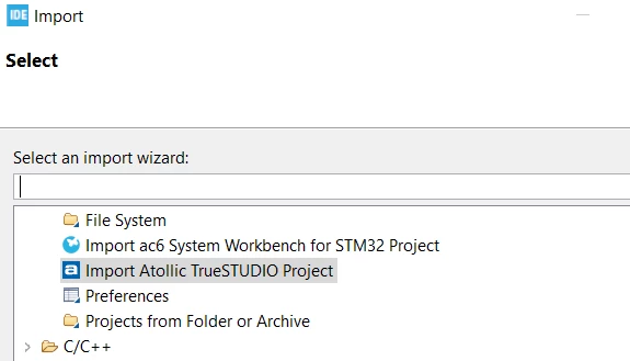

I have semi-successfully imported the BlueNRG BLE_SensorDemo_BlueMSapp demo code using the STMCubeIDE TrueStudio import wizard, flashed it, and run it on the STEVAL-IDB007V1M with the BlueNRG android app.
the wizard asks for the M0 version.... I chose the first one as I could not find the M0 cortex processor in any SPBTLE-1S documentation. which one is it actually? the first choice in the list ran, and streamed pressure and temperature, but I need to make sure its the right selection.
Next step will be to port this reference code to my SPBTLE-1S design. I need to have access to the correct architecture, so knowing which M0 to choose is kinda important

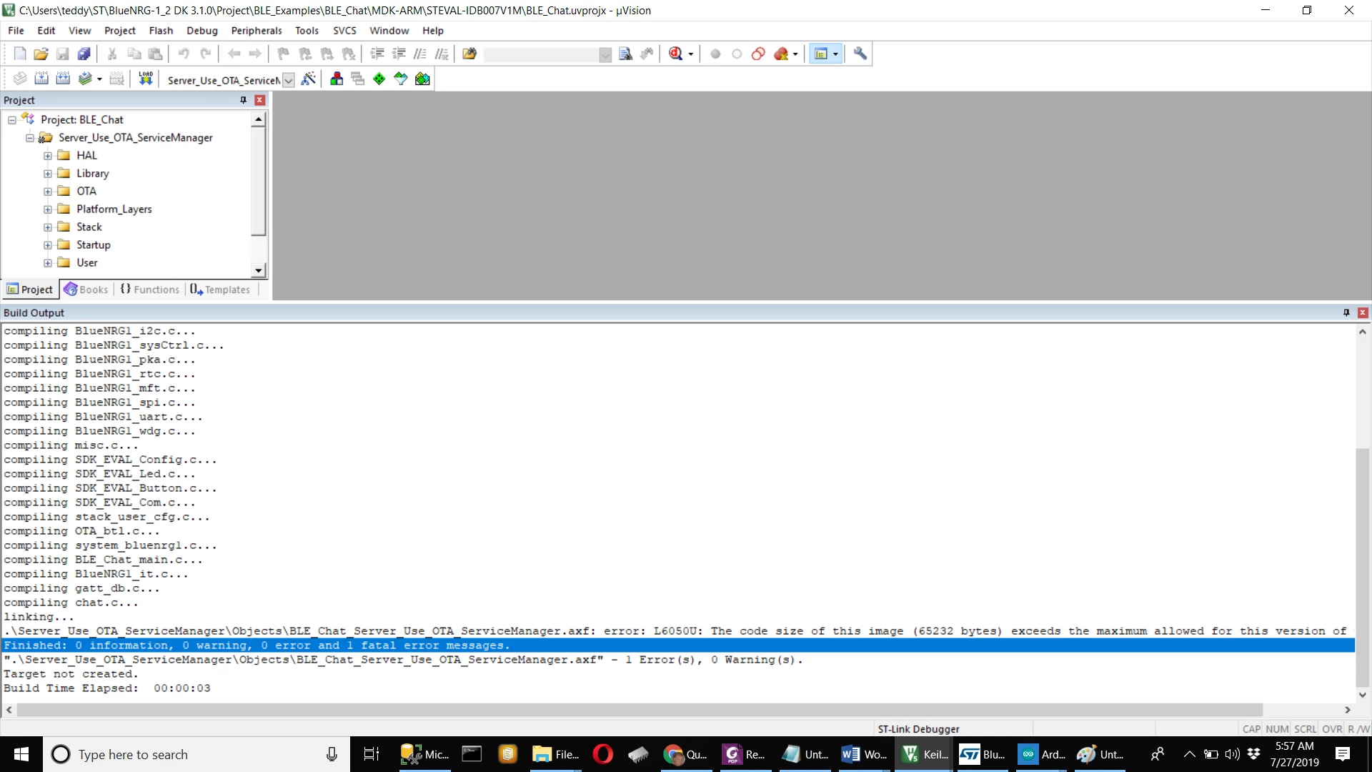

Salvo wrote "Keil is free for all ST devices based on Cortex M0."
sure , with a 32K limit, which means that any code that actually uses the Bluetooth on the BlueNRG-1 won't compile . see attached
Salvo
Jul 29, 2019 3:56 PM UTC
​Hello,
no, there is no code size limitation. Keil is free for all ST devices based on Cortex M0 with no code size limitation
Please refer to Keil website:
https://www2.keil.com/stmicroelectronics-stm32/mdk
and follow the procedure to activate the permanent license.
Best regards,
ST Support
bluenow1896
Aug 26, 2019 3:45 PM UTC
Have anyone find proper way to develop BlueNRG-1/2 on STM32CubeIDE? I'm very interested.
Keil is good but I like to work on Linux. Keil seems like no plan to support on Linux and I don't want to bother to create a virtual machine over Linux.
One of workaround could be to chose a M0 based ST micro on STM32CubeIDE and then tweak the Link file manually.
A question to ST support, how difficult it is to support BlueNRG-1/2 on STM32CubeIDE natively? Will ST do it?
