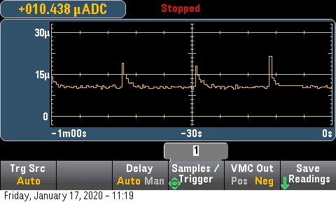

BlueNRG-2 VTimer wake-up the system every 15 sec
Hello
We're using BlueNRG-2 VTimer to be RTC for wake-up the system when it's in sleeping mode.
when we set the timer 10mins, it still wake-up the the system every 15 sec.
HAL_VTimerStart_ms(0, 600000);
But I don't turn on the other timer such as 1 or 2 or 3
HAL_VTimer_Stop(1);
HAL_VTimer_Stop(2);
HAL_VTimer_Stop(3);
the callback function still return the interrupt source is from timer 2.
HAL_VTimerTimeoutCallback();
is it possible? how do I solve this issue?
it increases whole the power consumption for nothing..

    This is expected. It is how the system was implemented.
    The system needs to wake-up periodically about every 15 seconds due to some internal mechanisms.
    However, the related user callback will trigger only when the timeout that you specified expires.
    The application can still leverage the callbacks to have large timeouts.

    >but the system returns from SLEEPMODE_WAKETIMER in 15s and does not go into sleep again
    Correction needed here. The system needs to wake up at the first 15 second, quickly do some HW chores, go to sleep again, then wait for the next 15 seconds.
    The overall power consumption will remain very low, since the the amount of time for these awaking periods compared to sleeping periods is very small (less than 1%, i don't have precise number currently).
    >there is no mention of this behaviour in the datasheets(At least I couldn't find some)
    Consider it as some hardware limitation. I guess that the Cortex M0 core was originally designed specific to the BLE application only, so this feature was just good enough. In BLE application, the timer to wake up the system does not need to be more than 10.x seconds. With the HW design of this chips, i am not aware of a workaround to get rid of these 15s waking-ups.
