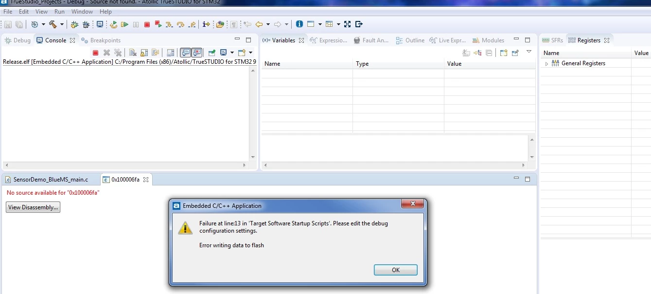

Please help I'm stuck with this, I am currently having some difficulties while programming and debugging the BlueNRG-2 ''STEVAL-IDB008V2'' over STLink/v2.
PROBLEM FACED : When trying to debug and flash the code using TrueStudio getting following error message
Failure at line:13 in 'Target Software Startup Scripts'. Please edit the debug configuration settings. Error writing data to flash0690X0000060PHjQAM.jpg

Correction : further debug, even IAR would not work running debugger for project "BLE_SensorDemo_BlueMSapp"... Anyone able to get ST release working with debugger ??

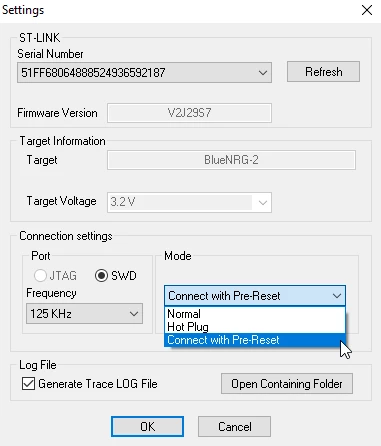

Aug 13, 2019 11:15 AM UTC
Hi
the funy things is, Segger JLINK EDU works without any tricks, why? It is able to start debuging, no matter of the CPU state. STLINk should be able too.
BR
KWT
Winfred LU
Aug 14, 2019 5:38 AM UTC
Possibly it is because that the Reset pin is controlled properly.
Please refer to Target | Settings | Mode in ST-Link utility,
For the mode "Connect with Pre-Reset", it is useful in many cases like when the target contains a code that disables the JTAG/SWD pins.

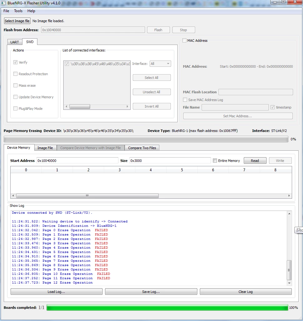

MRey.1
Jan 28, 2021 3:38 PM UTC
I know it's old, but were you able to solve this problem? I'm facing the same now

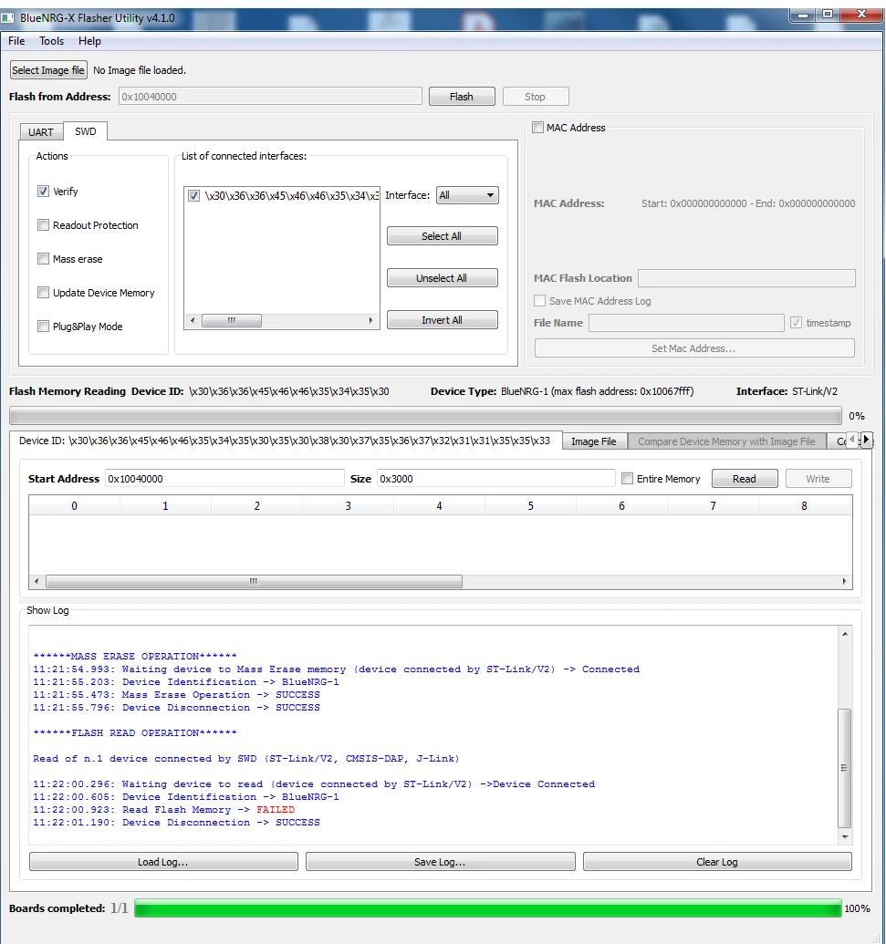

Winfred LU
Jan 29, 2021 1:02 AM UTC
Please try to erase the flash firstly.
MRey.1
Jan 29, 2021 2:28 PM UTC
Thanks for the response. I tried to erase it with Keil and BLUENRG-X Flasher, it says that it erased successfully, but it still can't be read
0693W000007DEXrQAO.pngBesides, if I try to erase by pages, it fails, so I believe it can't actually erase the chipI've also tried resetting with BOOT in high, but there were no differences so far
