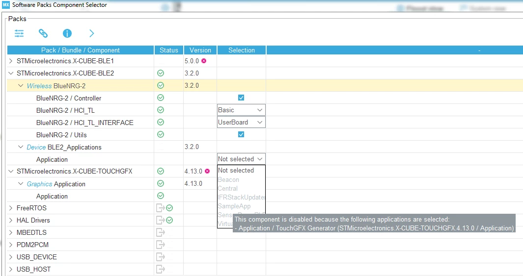

Hi all,
I am working on custom bord with STM32F746NG with LCD screen and a bluetooth mesh module.
I would like to use TouchGFX and I recently discovered X-CUBE-BLE2 with BlueNRG-M2. However, in STM32CubeMx I saw it's not possible to have TouchGFX Generator and BLE2_Applications.
0693W00000BcHTtQAN.pngWith STM32F7, is it possible to communicate with BlueNRG-M2 module only with BlueNRG-2 package or BLE2_Applications in STM32CubeMX is necessary ?
For mesh application I saw X-CUBE-BLEMESH1 but I didn't find it in STM32CubeMX. I suppose I have to add it manually ?
Regards,
Tom,
