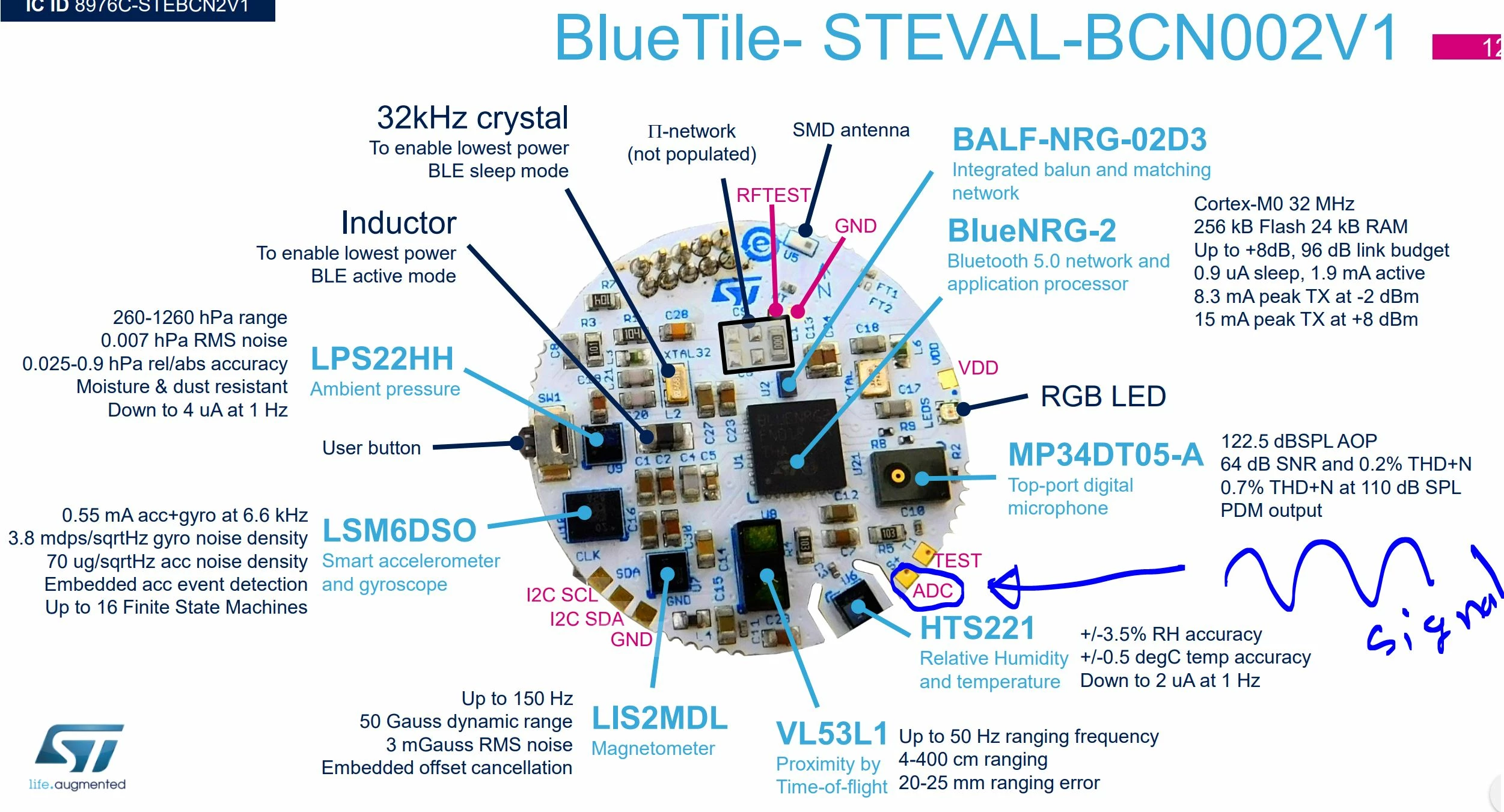

BlueTile can use ADC port?
if we connect the signal to ADC port, Can we display on ST ble APP ?
