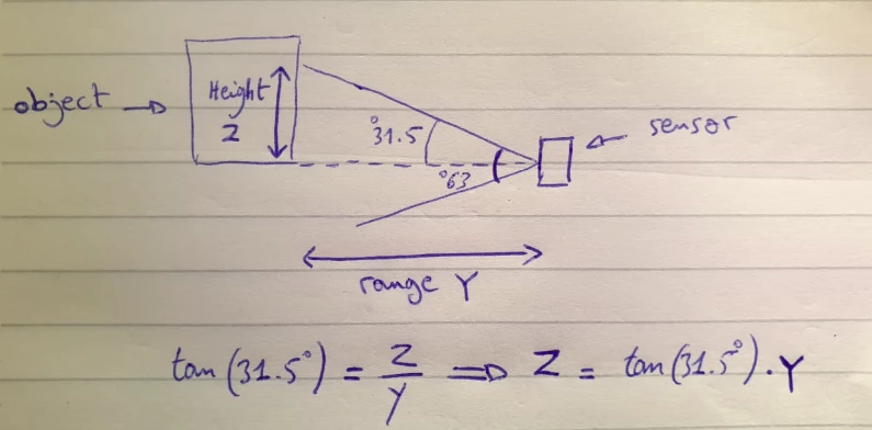

Hello @John E KVAM​
thanks for your answer,
I am indeed working with the X-NUCLEO-53L5A1 for that matter, and, knowing that it has a wide 63 ° diagonal FoV, I can multiply tan(31.5) by the range of the detected object to obtain the height Z ( maximum height for that certain range ).
Is my method correct what do you think ?
John E KVAM
December 7, 2022
You are seeing the 8x8 grid of distances. I'd call it a 45x45 FoV. So each zone is about a 5x5 degree pyrimid. And you can work out the direction from that as well as the distance. I like to use polar coordanates. (Remember those from high school?) it gives a direction and a height.

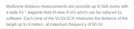

Hello @John E KVAM​ ,
you will find attached the method I am talking about explained in details, so you can understand me better.
also this is where I found about the 63 degrees FoV : https://www.st.com/en/embedded-software/stsw-img024.html0693W00000WKX7wQAH.pngThanks.
John E KVAM
December 8, 2022
I think I understand what you are thinking. And the sensor does it for you.
if you put this sensor 1M from a wall, and perpendicular to it.
You will get 64 zones all saying very close to 1M/
We did the radial-to-perpenducular calculation for you.
You don't need to do any math.
Just run the experiment and prove it does what you want it to.

WYous.1
WYous.1Author
December 8, 2022
Hello @John E KVAM​ and thanks for your answer,
actually I did something similar to that and I know it gives me great results but my ultimate goal is to calculate the height of the detected object and not it's distance from the sensor that's why I first thought of the method I explained to you at first which is this
0693W00000WKaiXQAT.pngthe issue with this is that it is range dependant and only gives max height for a given range
Hello @John E KVAM​ in the source code of the 53L5A1_SimpleRanging can't we have an information about the angle of the detection of objects ? if so, I think I can determine the height of that object with calculation
