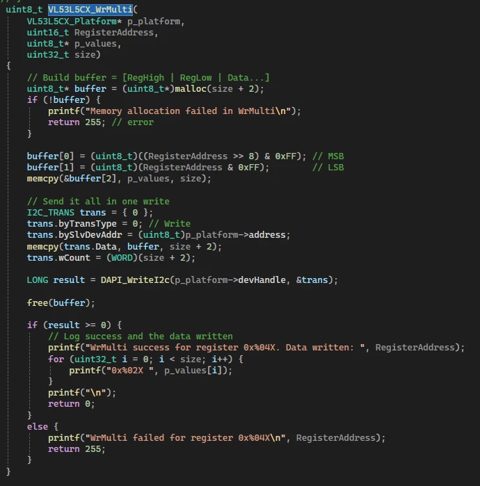

I am having trouble in uploading firmware please see if there is some error i am using DevaSys board and every time getting init failed i am attaching the logs also

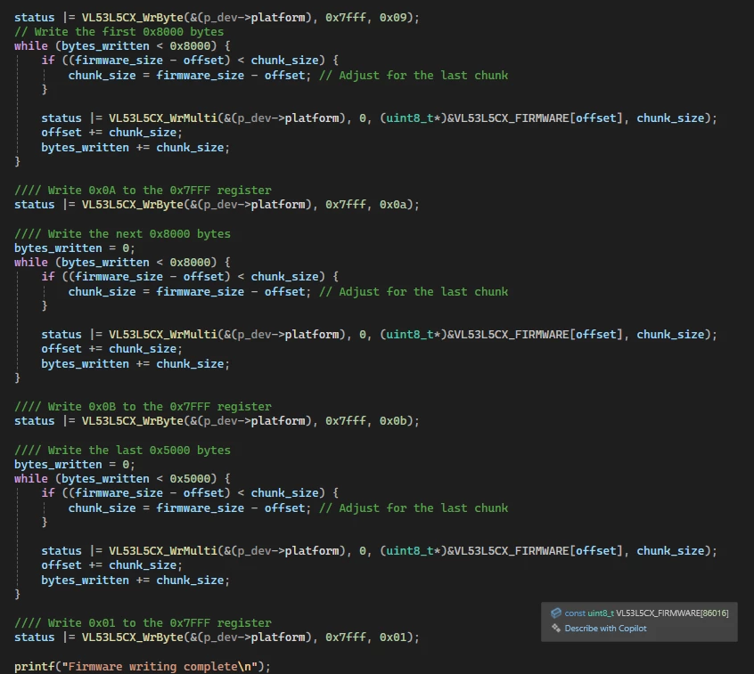

Zhiyuan.Han
Sep 30, 2025 8:15 AM UTC
Hi
From your log seems IC read write successfully with short data length, like vl53l5cx_is_alive() you have tried to read the device information, and the I2C works well.
The issue happens when you are trying to write big size date to device inside vl53l5cx_is_alive(), which used to download the FW to the device, take below line for example, the data's is 0x8000 bytes long, so my suggestion is to check if your platform supporting such big size data writing.  if not supported by your platform., you can try to split the big size into two 0x4000 .

Visitor II
Sep 30, 2025 8:23 AM UTC
below is when i split the firmware into small chunk 16 bytes i am able to write
Please check if these two are correct to write the firmware
