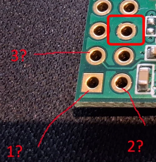

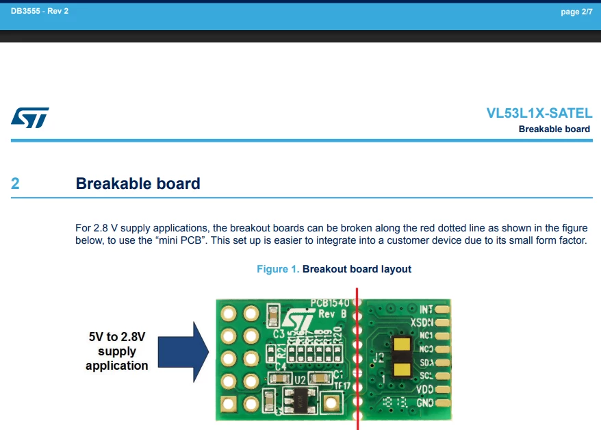

The documentation shows which pins are what, but it confuses me, as the layout in the documentation seems to be different than the boards itself.
Of the 10 pin holes on the board, one hole has a square around it, indiciating that would be pin 1. Across would be pin 2, and then on to the next row for the rest.
The square is on the outside column of the board.
However in the documentation pin 1 is on the inside column of the board.
What is the correct way to connect this?
Indeed.

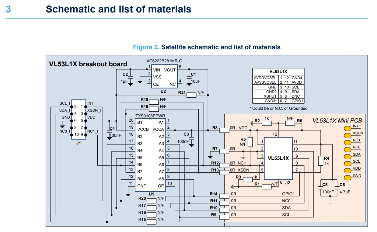

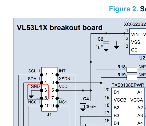

Also, looking at the board & carrying on with that counting would say that pin 6 must be ground:
Which corresponds to the Data Brief:
Which document are you referring to?
I only see that DB3555 Data Brief, and the only board layout in that is the photo:

I am indeed referencing the DB 3555 Rev2 manual, it has the diagram on page 3.

Is the square indeed  on all PCB's always number 1, and is number two always next to it?
You said you could tell 6 is the ground by looking at the board. Is that because of the four tiny dots around it?
you mean this:
That's a schematic - there's nothing on that which specifies physical positioning.
Schematics are about connections - not physical layout.
They are topological - not topographical.
It is a common practice.

ST are by no means the only ones guilty of this - this is an all too common documentation fail.
Pin numbering needs to be explicitly and clearly defined:
  • Where is pin one?
  • How does the numbering go from there?
