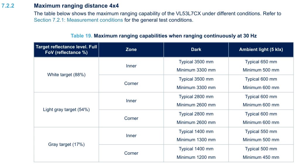

What is the maximum detection distance of the VL53L7CX for a black object?
I am using the VL53L7CX in an object detection system.
Today, I found that the sensor does not detect black objects well. It can only detect a black object at a very short distance, approximately 10 cm.
Is this the expected behavior?

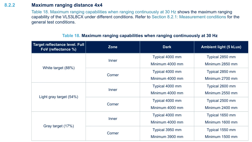

If so, what is the maximum detection distance of the VL53L8CX for a black object?
My application requires the sensor to reliably detect a black object at a distance of about 50 cm.
Is there any way to improve the detection performance for black objects, such as changing the configuration or tuning any parameters?
Thank you.

Hi:
In VL53L7CX datasheet, when the reflectance is 17% and under 5klx ambient, we can get min distance 500mm in inner zone and min distance 450mm in corner zone.
In VL53L8CX datasheet, when the reflectance is 17% and under 5klx ambient, we can get min distance 1600mm in inner zone and min distance 1500mm in corner zone.
if you follow the measurement conditions, it should can cover your requirement.

AScha.3
Aug 11, 2026 1:04 PM UTC
you know, these kind of sensors working by detecting a reflected light-pulse .
So basically a perfekt not-reflecting ( 100% black) surface is by definition of working principle invisible for them.
So maximum detection distance for not-reflecting ( 100% black) is impossible to give, or zero, if you prefer.
