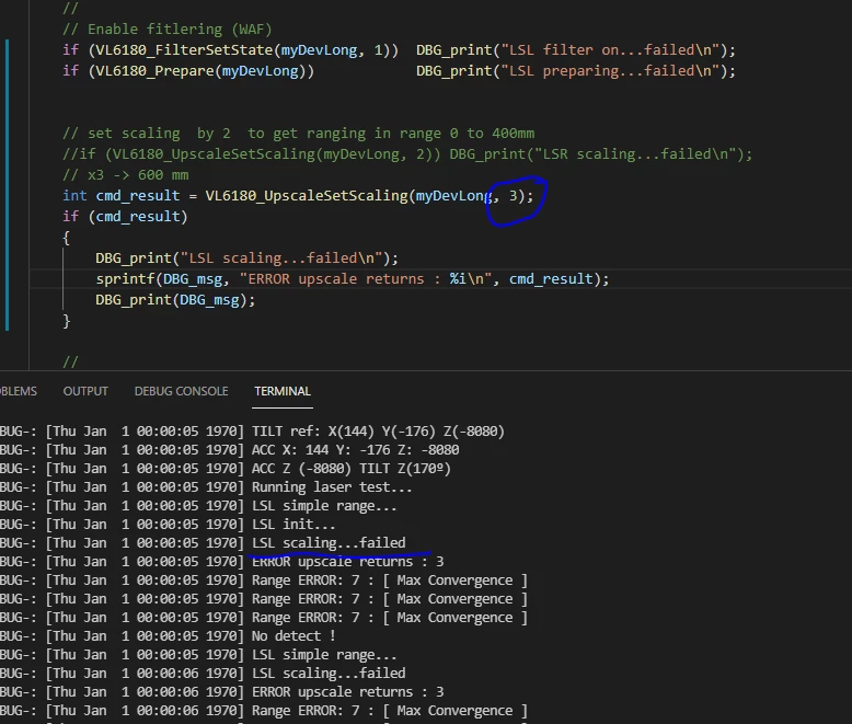

It seems the API does not allow to range up to 600mm, why?
I am ranging ok up to ~350mm.

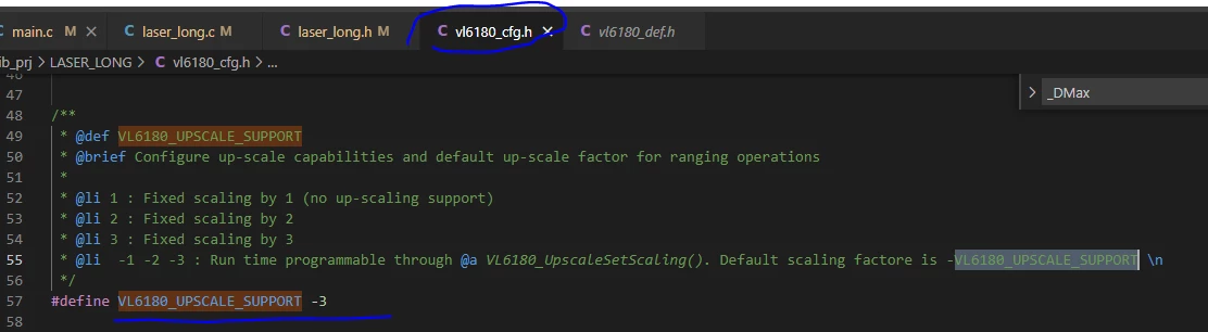

I have tried to use x3 upscaling, but error is returned when doing so by:
VL6180Dev_t    myDevLong;
VL6180_UpscaleSetScaling(myDevLong, 3);
It seems as upScaling it is not allowed, but it is enabled in vl6180_cfg.h:
Can you please advice if I am doing anything wrong.
Regards, Ramon.

I understand what you say, but I am not sure what is going on with th upscaling.
Note the Upscaling is giving me an error ¿Is this normal?
0693W00000JMApKQAX.pngBy the way, I have tried larger surfaces. In spite of detecting further objects it can not detect futher than 350mm.
Regards, Ramon.

the up-scaling is not giving you the error. Upscaling only occurs because the chip designers use an 8-bit byte to return the distance, never imagining anyone would want to range beyond 255mm. But it clearly works farther than that. So upscaling is simply dividing the range result by 2 (or 3) and retuning that value - then multiplying the result back up on the MCU end.
It's still the lack of photons that is giving you that error. The Max convergence says that you did not get enough photons before the timer ran out. You can increase your Max Convergence time and allow the sensor to gather more photons. Or use a mirror (or other really bright target) to reflect more photons.
The sensor is rated to 600mm, but that is the best it can do in ideal conditions. Realistically as you have seen, normal targets are good to about what you are getting.
So the problem is physics. The light decreases as a square of the distance, so at the longer distances one really has to work to get the required number of photons.

I understand the range error is due to lack of photons back. I will try increasing convergence time.
I was trying to understand why the upScaling function is not returning 0 when set to x2 or x3. It returns 3 instead.
I am using VL6180 and VL6180X, but I am using only the range part (not the ALS). My question is: Is there any difference in terms of ranging?
Regards, Ramon

I'm not sure why the upscaling function is not returning the 0 as you expect.
Might have to dig through the code for that. But you can do it.
