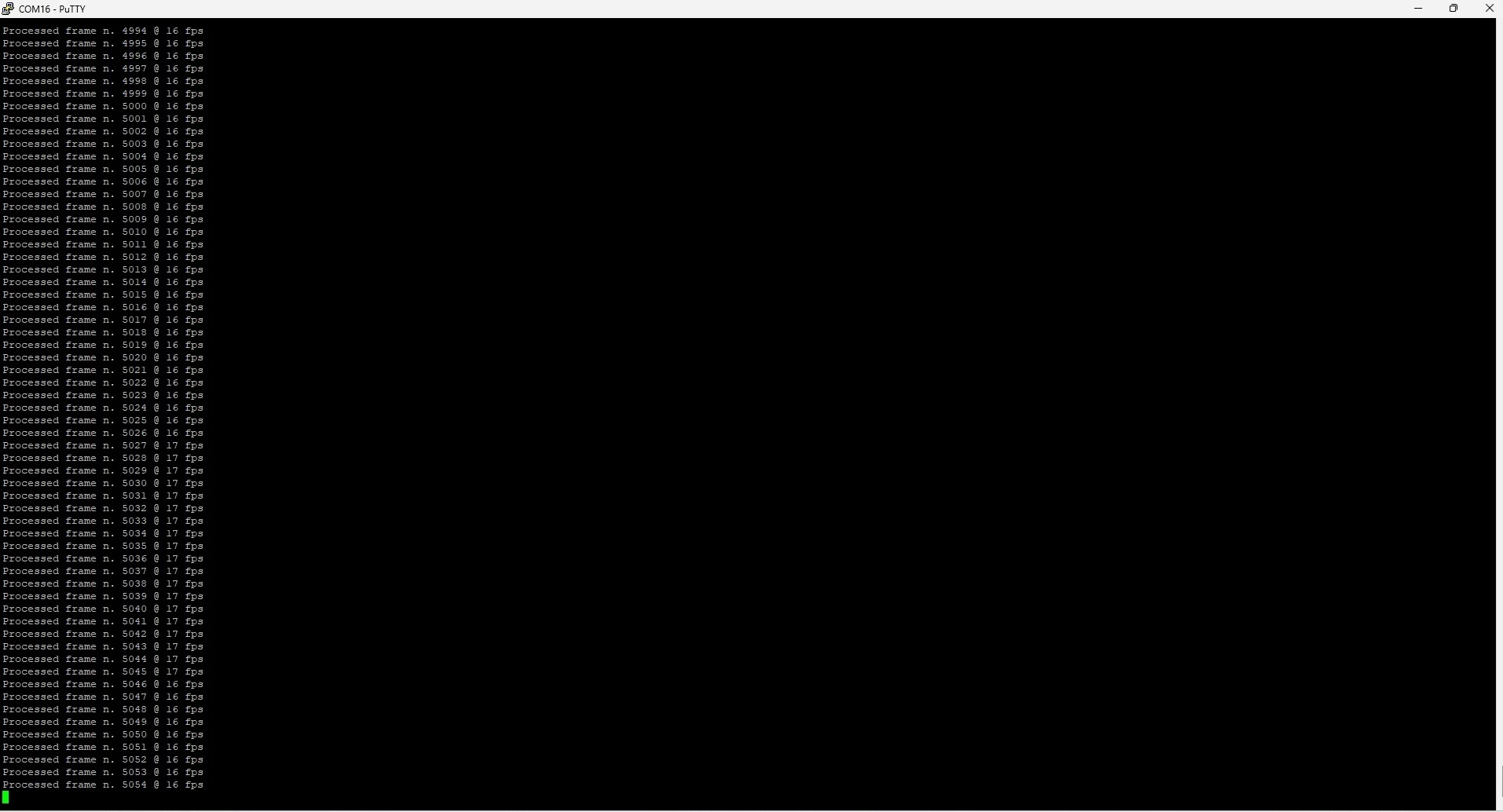

I have the X-NUCLEO-53L9A1 board and NUCLEO.H563ZI. I load the binary provided by ST (53L9A1_PostprocessSingle.bin) and I attach what I get in the serial terminal. I was expecting different data, like a distance value array that I could draw as bitmaps. How is this supposed to work?

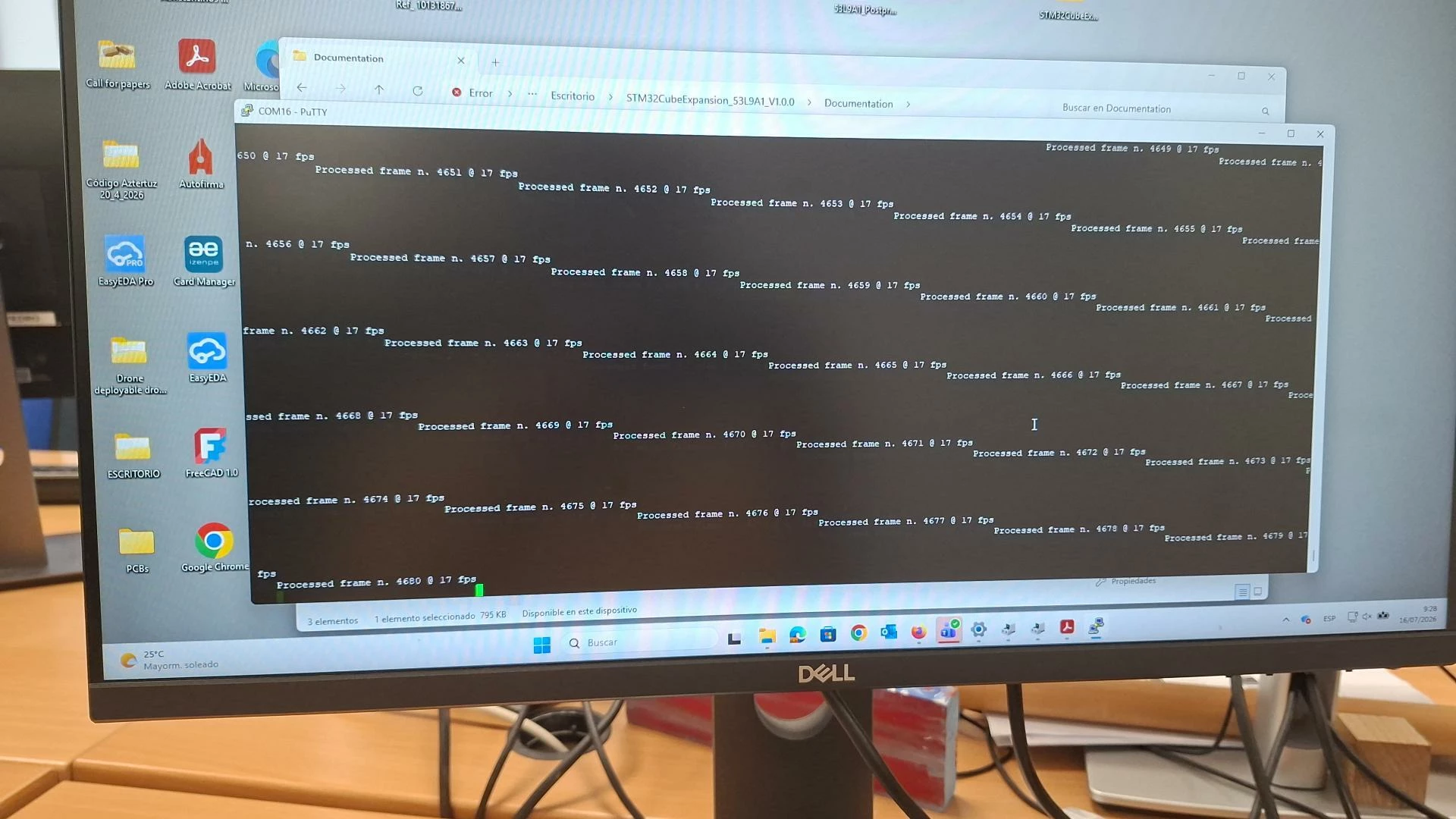

Andrew Neil
Jul 16, 2026 9:46 AM UTC
When you get a display like that on a serial terminal, it means that your line endings configuration is wrong.
The software is terminating lines with just a Line-Feed (LF, ASCII 0x0A), but the terminal is expecting Carriage-Return (CR, 0x0D) and LF (sometimes written “CRLF”).
It looks like you’re using PuTTY - for that, you need to enable the ‘Implicit CR in every LF’  option.

Jul 16, 2026 10:08 AM UTC
Thank you very much,
The line endings configuration looks right now. But I still was expecting to get an array of distance reading values… not “processed frame nº”.

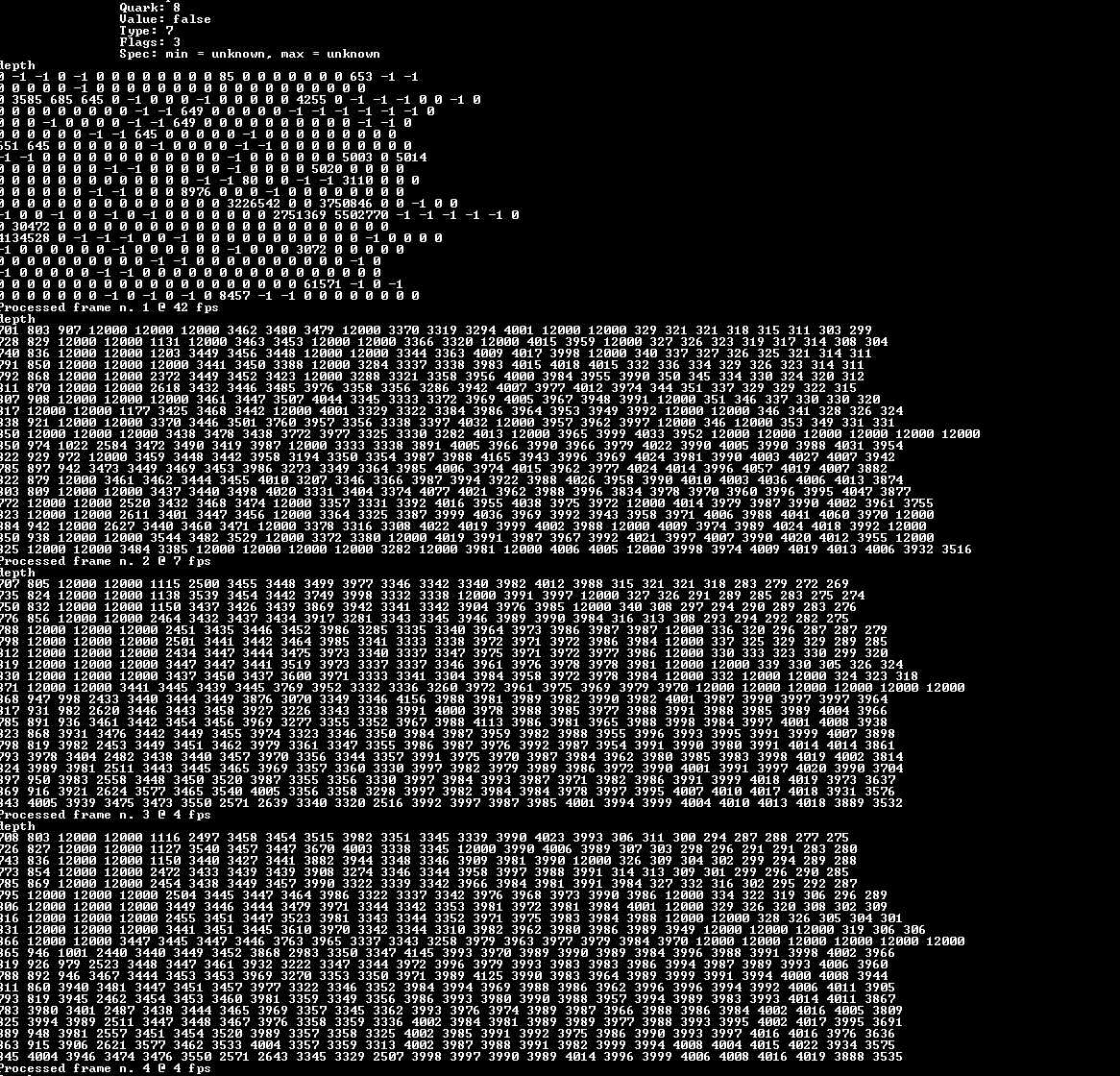

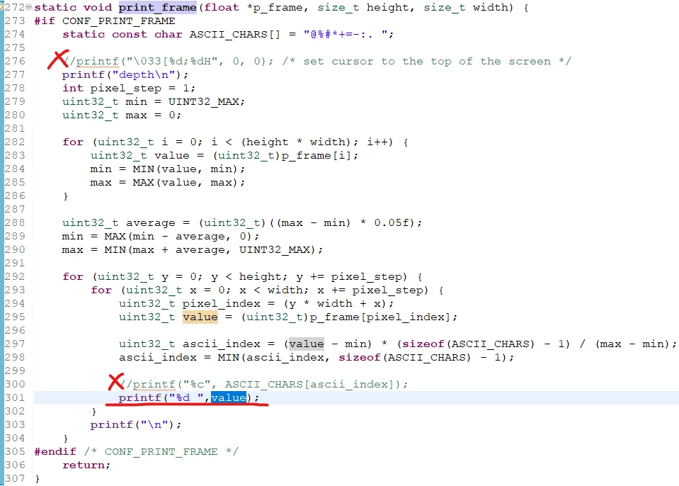

BinBest answer
Aug 14, 2026 8:54 AM UTC
Hi:
please refer to below modification, rebuild driver code and flash the sample application.
then you will get distance array.
Best regards,
Bin FAN
