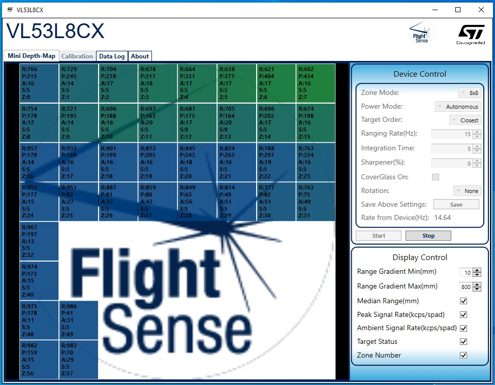

I've recently discovered that during my test of the Time of Flight (ToF) sensor from my table to the ground, the sensor was positioned away from the table, facing downwards. While conducting the measurement, my knee was in close proximity, causing a variation in the measurement at the top left corner. Ideally, it should have displayed a distance of 250mm rather than a negative value of -2mm.
i also noticed that sometimes the "VL53L8CX_GUI" shows not all measurements:
As you can see where the LOGO "Flight Sense" is shown there are no measured pixels. I think the GUI software somehow evaluates which pixels have high confidence and which have little confidence. What is driving the decision? I think i would be fine if i could just use the same values as this example software.
John E KVAM
John E KVAMBest answer
February 26, 2024
When the sensor does not return a 5, a 6 or a 9 as status, the PC software does not plot it.
