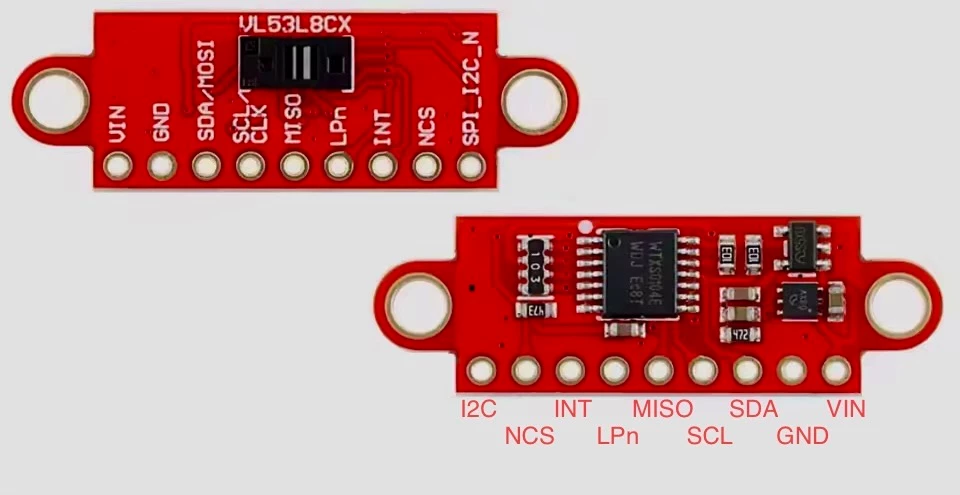

I am using a Chinese VL53L8CX module from AliExpress, not the official ST evaluation board. I want to stress that in the first sentence because this may be important: this is a Chinese AliExpress breakout, not the original ST hardware. The same module works on my setup over I2C, but I am trying to bring it up over SPI on an ESP32-S3 and I am stuck at a very specific point.
What already works:
- The same sensor/module works over I2C on this board.
- In SPI mode I can repeatedly read the hardware ID correctly: `dev=0xF0`, `rev=0x0C`.
- `vl53l8cx_is_alive()` often returns `status=0, alive=1`.
What fails:
- `vl53l8cx_init()` never completes successfully.
- The failure happens around the software reboot / boot polling stage.
My hardware/software context:
- ESP32-S3
- custom firmware using Arduino + ESP-IDF SPI path
- Chinese AliExpress VL53L8CX module
- `SPI_I2C_N` forced HIGH for SPI mode
- level-shifted module, jumper wires about 20 cm
- SPI mode 3
- SPI clock currently conservative, around 1.2 MHz
This is the reset / startup sequence I currently use on the adapter side:

Typical log in the “better” runs looks like this:
[L8CX] raw id status=0 dev=0xf0 rev=0x0c
[L8CX] is_alive status=0 alive=1
[L8CX] pre-init go2 status=0 reg06=0x00 reg07=0x00
[L8CX-ULD] init: pre-sw-reboot reg06=0x00 reg07=0x00
[L8CX-ULD] init: sw reboot begin
[L8CX-ULD] init: poll boot fail status=1
The most interesting alternative state I have ever seen is this:
[L8CX] pre-init go2 status=0 reg06=0x80 reg07=0x05
[L8CX-ULD] init: pre-sw-reboot reg06=0x80 reg07=0x05
But even in that case, after the software reboot sequence the sensor falls back and boot polling still fails.
I also had one weaker case with:
reg06=0x00 reg07=0x02
Questions for the community:
1. Do `reg06=0x80` and `reg07=0x05` mean anything documented for VL53L8CX boot ROM / SPI bring-up?
2. Is it expected that raw SPI ID and even `is_alive()` can work while the device is still not in a valid post-boot SPI state?
3. Is there any known SPI-specific variation of the software reboot sequence for VL53L8CX, especially around registers `0x000F`, `0x000A`, and `0x4002`?
4. Has anyone successfully used a Chinese/AliExpress VL53L8CX breakout over SPI with ULD, not the official ST hardware?
5. Could onboard level shifting or non-official board design explain a case where SPI raw ID works but `vl53l8cx_init()` never reaches boot-ready state?
If useful, I can also share full logs and a larger code excerpt.

I looked into this forum topic more carefully, and it turns out my module uses the wrong level shifter.
This is a Chinese VL53L8CX breakout, and it appears to be populated with an unsuitable translator chip for this application. So the problem is most likely not in my firmware, but in the hardware design of the module itself.
That explains why I could get partial communication but never stable full initialization.
Thanks to everyone who pointed me in that direction.Sdbd910448b764b658941e534ecd66a26S.jpg_960x960q75.jpg_.jpeg

Hi
Glad to hear you have found the root cause. Congratulations~
