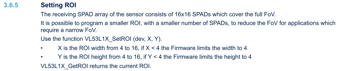

Hi, I am evaluating VL53L8CX and couldn’t find anything in the data sheet about a programmable FOV. I require a FOV of 2-3degrees. Does this sensor support a programmable FOV to that size?

VL53L8CX can’t support to program FOV. We only have a few that can be supported, such as VL53L1CX/CB. The API interfaces are as follows for your reference
A guide to using the VL53L1X ultra lite driver - User manual
