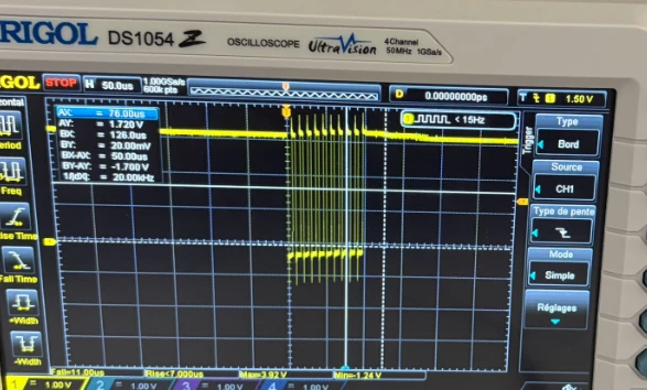

I have succes to have the I2C signal on sda lines for the 1V8 and 3V3 part on oscilloscope :
But when i’m connecting in i2C, i make a scan i2C (you can see the code C). The problem is that i have a NACK (not acknowledged) when i scan i2C bus. I changed my ToF many time so i can’t say that is a hardware problem.

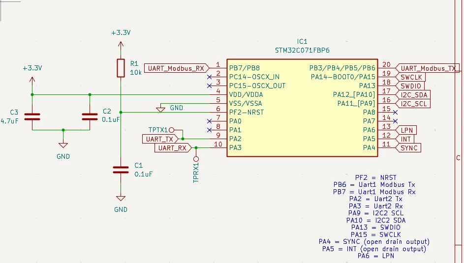

You can see my shematic :

Thanks for the detailed information. At this stage, it would be useful to check the schematic(The schematic you provided doesn't show anything), because repeated NACKs are often caused by I2C pin mapping issues, LPn/XSHUT not being released correctly, or bus electrical problems such as pull-ups and voltage levels.
Could you share the schematic for the STM32C071 ↔ VL53L8CX connections, especially power, SCL/SDA, pull-ups, and LPn/XSHUT? If possible, oscilloscope captures of SCL, SDA, and LPn/XSHUT would also help to determine whether this is a software configuration issue or a hardware connectivity/electrical issue.

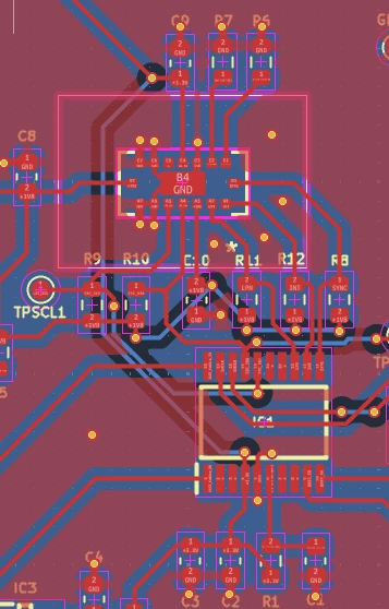

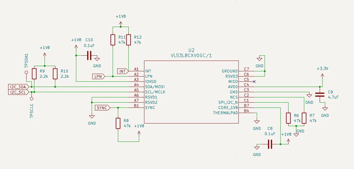

Thank you for your reply. Here, you can see my schematic for the ToF, and the STM32C071.
Moreover, i have 1 LDO for the tension 3V3 to 1V8, to convert logical level 1V8 to 3V3 i have add a level shifter.

My real problem, is that i don’t have the good logical level for the I2C in the TOF side : the normal resting state is 1V8 or 3V3 for the i2c bus. In my case, i observed signal from 0V to high level. And so, in a resting state i have 0V logical state instead of high level.
My Lpn seems good with 1V8, and i observed well tensions for the 2 modules (STM and ToF).

The new information is very useful. If the I2C lines on the VL53L8CX side are at 0 V in idle state, that is already abnormal for I2C, since both SDA and SCL should be pulled high when the bus is idle.
In that case, the NACK is very likely only a consequence of a electrical issue. The next points to check would be:
  • the exact level shifter type and schematic, to confirm it is suitable for bidirectional open-drain I2C,
  • whether SDA or SCL is being held low by the level shifter, the MCU side, or the sensor side,
  • whether the STM32 pins are really configured as I2C open-drain AF and not being driven low,
  • and whether the VL53L8CX power / IOVDD / interface mode pins match the datasheet recommendation.
A very useful test would be to isolate the bus step by step:
  1. disconnect the level shifter from the MCU side and check whether the ToF side returns to 1.8 V idle,
  2. disconnect the sensor side and check whether the translator output is still stuck low,
  3. measure idle voltage separately on STM32 side SDA/SCL and VL53L8CX side SDA/SCL.
