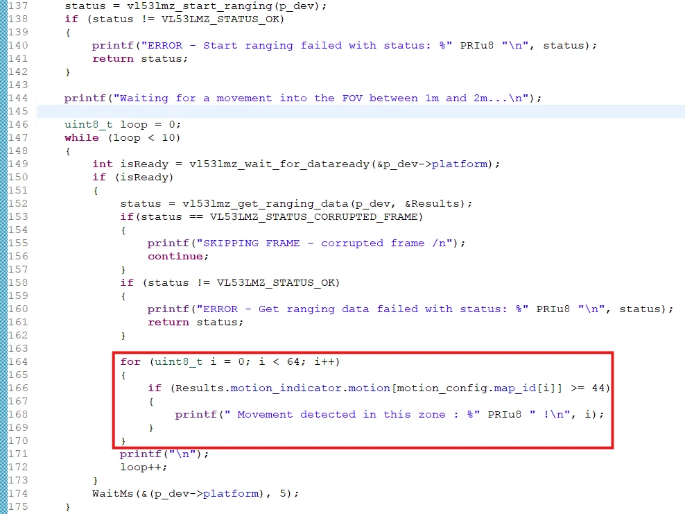

When using a vl53l8cx configured for motion detection, which of the fields in the motion_indicator struct can I check to see if there was motion?
I understand that the motion[32] array has measurements but I'd like to be able to poll this infrequently and check if there was an event between these polls. Something like a motion_detected flag that latches?
Thanks!

From the current example code, the motion detection plugin does **not** appear to provide a separate latched `motion_detected` flag in the result structure.
The intended usage is to:
1. configure the **motion indicator**,
2. set **detection thresholds** on `VL53LMZ_MOTION_INDICATOR`,
3. read the ranging results,
4. check whether `Results.motion_indicator.motion[...]` exceeds the configured threshold.
In the example, motion is considered detected when the motion indicator value of a zone is greater than or equal to the configured threshold:
So, based on the provided ULD example, motion detection is done through **threshold comparison on `motion[]` values**, not through a sticky event flag.
If your application cannot use interrupts and needs infrequent polling, then a latched “motion happened since last poll” behavior would need to be implemented on the host side.

Thanks for your prompt response. I’ll take a look at SPD, however my question was about the motion detection plugin in the uld driver (v2.0.1) here: https://www.st.com/en/embedded-software/stsw-img040.html
What I’m hoping for is a way to reduce the polling frequency to the sensor (interrupts are not available on this revision or the design)
Thanks

​@db16122 the manual does not provide much information as to how to interpret the fields in the struct. That's my original question.
I'm trying to reduce polling frequency because this version of the design has a very congested I2C shared bus and it's causing issues.
Thanks

If I2C is too busy while MCU is comparatively free, you can increase the I2C freq to maximum like 1000kHz.The polling freq is decided by microcontroller side, motion detected status is ready by the sensor. Maybe you can modify the polling freq to low and increase the I2C freq to maximum. This will give you more freedom I2C bus
