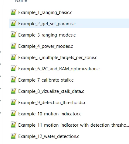

Hi:
Can you share the pin connection between L8CX and STM32G0B1KBU6? By default, L8CX ULD is based on STM32F401, the connection of the pins may need to be redefined.
In addition, VL53L8CX_ULD_driver_2.0.1 package, we have 12 examples code, can you log all print data of example1 and example9?
Best regards,
Bin FAN
