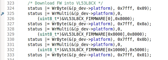

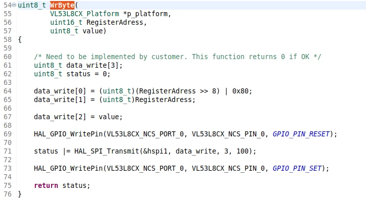

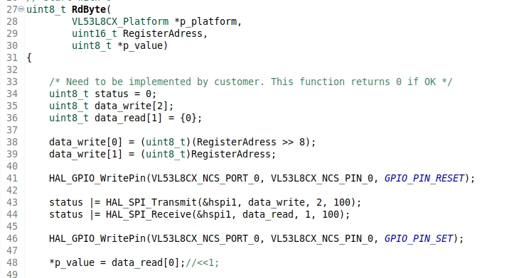

there is my function to send data throught SPI :
And to receive data  :

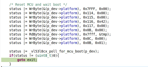

The problem is in function vl53l8cx_init.
There is timeout in various function depending on SPI frequency and apb frequency
timeout can come from this line (325) or from _vl53l8cx_poll_for_mcu_boot function.
Often timeout appear at the third occurrence of _vl53l8cx_poll_for_mcu_boot function.
I'm clearly lost in the search for the causes of this problem. I tried to increase or decrease the SPI frequency but this only change the line where the timeout occurs.
I remain available for any further information.
Thx for every kind of help !

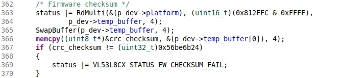

When i use this new version on the B-U585I-IOT02A board all work correctly but all was working before i change files for this newer ULD driver.
But on the U535 board there is a new error..
In the newer version of vl53l8cx_api.c crc_checksum always equal 0.
Do you have any information on the possible origin of this problem ?
Thx per advance.

Currently i'm trying with a 2.5 MHZ SPI clock but the init is crashing here :
