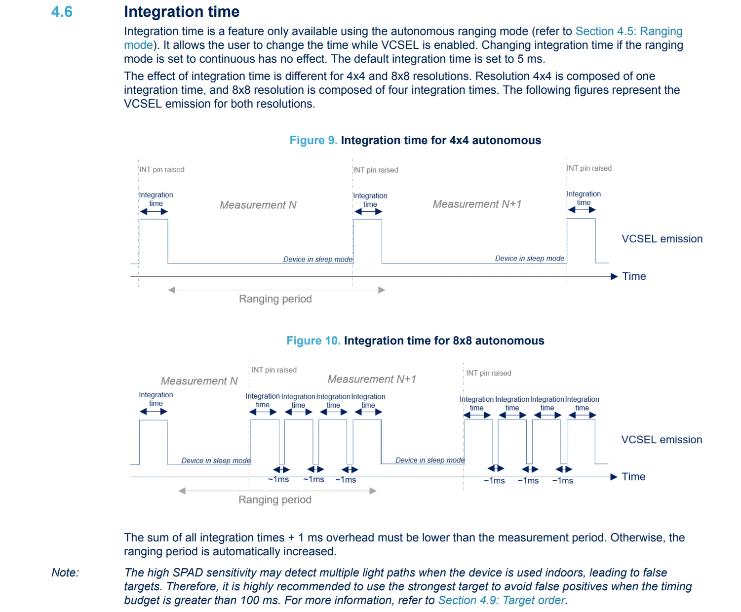

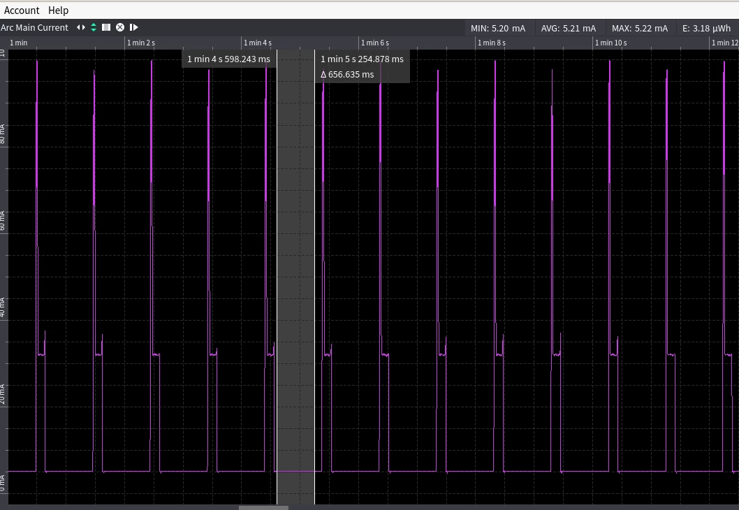

However, I have a question regarding the autonomous mode set to 1 Hz as described in the datasheet. According to the datasheet, between each measurement, the device should be in sleep mode, resulting in an average consumption of around 1.6 mA. However, I am observing an average consumption of 5.21 mA in this mode, as shown in the captures below. Could you please advise if there is a specific method to achieve the expected consumption between measurements?

According to the datasheet, the power states are:
The L5 referenced a Ultra low power idle mode. Perhaps that was what you were looking for.
Between ranges you should be in LP idle state waiting for a command. I believe you can drop the LPn pin to turn off the I2C interface which saves a bit. I did not see in the datasheet if that retains the memory or not. But the chart above seems to indicate that it does. It's not very clear, however.

Sir John, thank you very much for this information. I have successfully set up the ultra low power mode, and the sensor is now consuming only a few microamps.
