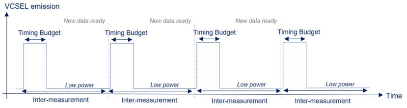

Hi:
if the ranging mode is VL53L8CX_RANGING_MODE_CONTINUOUS, integration time (Timing Budget) setting decides the frequence.
you can refer to the below diagram, it means when the first data ready, the operation of the second frame of data will immediately begin, and so on...
But if the ranging mode is VL53L8CX_RANGING_MODE_AUTONOMOUS, for example the below diagram: set the frequency 15hz means inter-measurement time is 66.67ms, the integration time (Timing Budget) setting less than the period for save power.

Samb22Author
Jul 6, 2026 8:35 AM UTC
Thank you for your valuables answers.
I succeed to filter the sunlight that comes in my sensor, in modifiying the integration time at 30ms.
But i noticed that the frequency is lower now. In fact, i record data during 30s and i have only 233 matrices. Also when i don’t have integration time in my soft i was at 15Hz with around 450 matrices for 30s (450/30=15).
Why this parameter influence the frequency ?
And was is really integration time in case of our TOF?
Thanks and regards
Samuel

Hi:
