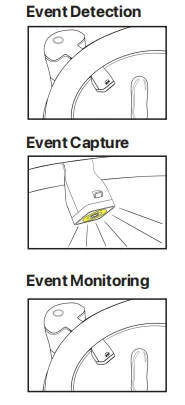

VL53L7CX performance issues in enclosed ceramic environment (toilet bowl) - "Low Confidence" during object drop
I am developing an object detection system using the sensor, integrated inside the inner wall of a toilet bowl to detect falling waste. I am experiencing persistent "Low Confidence" issues, and I am looking for expert advice on whether this is an inherent physical limitation or a configuration issue.
Current Setup & Environment:
  • Environment: Actual toilet bowl (highly reflective curved ceramic surfaces).
  • Hardware Integration: The sensor is mounted behind a cover glass, and an active NIR/Visible fill light is installed inside the bowl to assist a separate camera system.
  • Configuration: VL53L7CX_RANGING_MODE_AUTONOMOUS @ 60Hz.
The Phenomenon:
  • Static/Idle State: Even in this real-world environment (with cover glass and fill light), the sensor produces some "Low Confidence" data points even when nothing is happening.
  • Dynamic Event (Object Drop): When an object is dropped, the frequency of "Low Confidence" reports increases significantly, often rendering the detection logic unreliable.

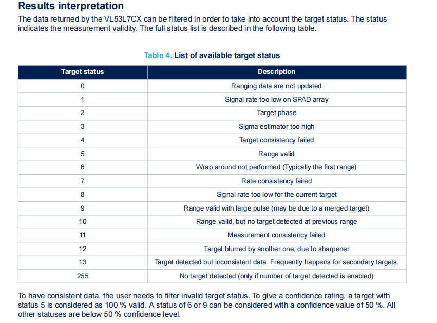

  • If autonomous mode is required, increase integration time and reduce the frame rate accordingly.
  • Use target status + sigma as the primary confidence filters.
  • Improve optical/mechanical isolation between the fill light and the ToF sensor.
