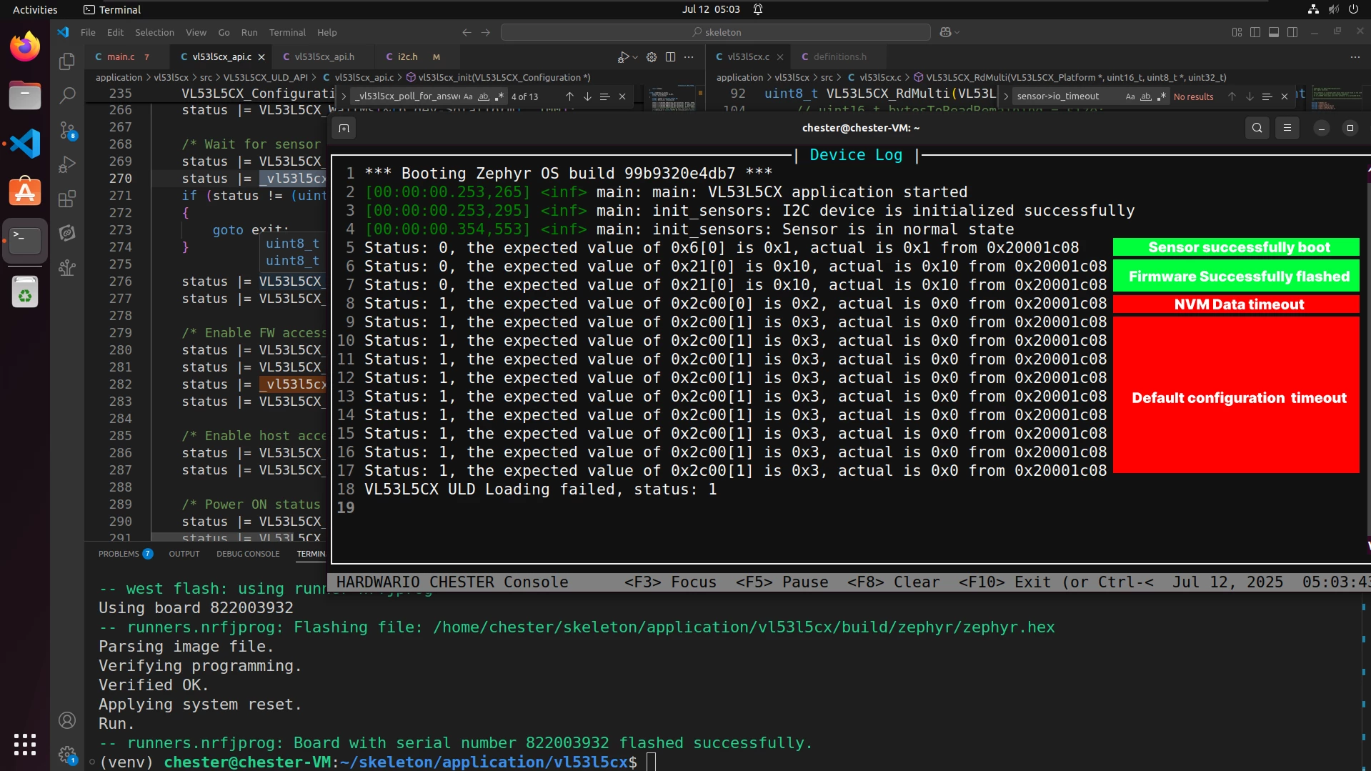

Hi everyone,
I have been struggling to work with VL53L5CX on my NRF board using Zephyr. I used the VL53L5CX_ULD_driver_2.0.1 API and changed the platform.cpp. So far, what my problem is as follows:
  • Failed on the vl53l5cx_init, because after the firmware is successfully flashed the  _vl53l5cx_poll_for_answer always gets the wrong value as attached image
My code is as follows:

Kindly help me if anyone has successfully used VL53L5CX on the Zephyr platform.
Thank you!

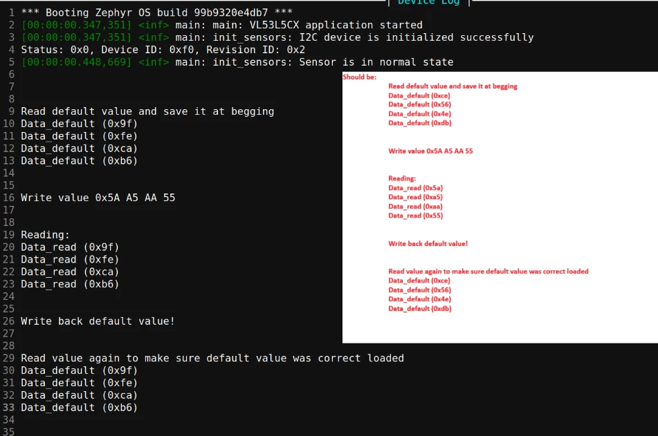

You are getting data so your I2C works, but that doesn't mean you don't have a byte swap issue. Or a word-swap issue.
The STM32 ST uses in it's demo code is a little-endian device, and the I2C interface is a big-endian device. So if you look at the code there is a lot of swapping going on.
The best way to tell if you have it the right way 'round is to write 4 bytes and read back 2 words, and then read back 1 long word. Then write one longword and read it back as 2 words and as 4 bytes.
There is some code to do this on the Forum somewhere, but I left my version of it at work.
Resolve these issues and I think you will be all set.
There is one other issue you might see. those really long I2C writes are not well handled by other MCUs. Do check to see that they have been completely written. And adjust the long writes into several shorter ones if you have an issue.
- john

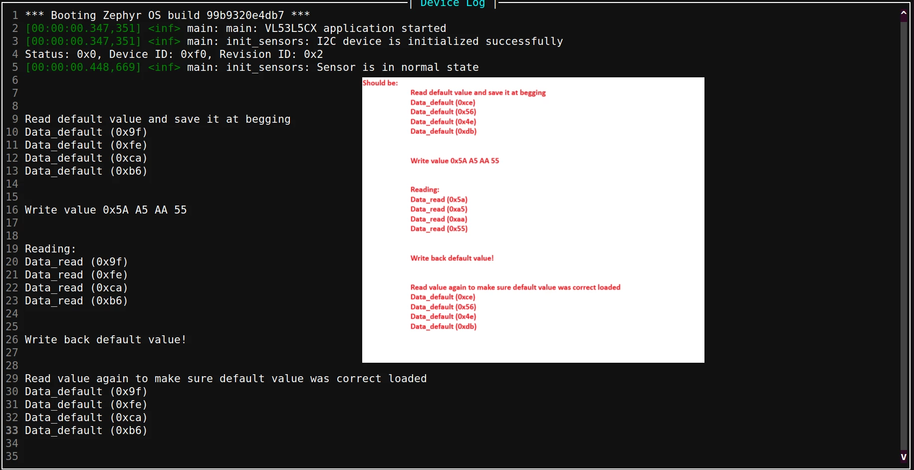

Thanks for informing. I appreciate your suggestion to check the data integrity. Is this the code for testing the data endianness that you wrote is in this link
https://community.st.com/t5/imaging-sensors/vl53l5cx-driver-vl53l5cx-init-fails/m-p/640829/highlight/true#M3626 ?
I have tested using that, and as you can see from my attached image, the data was wrong. For example, first data should be 0xCE, but read as 0x9F and so on. I have checked my WriteMultipleBytes using a logic analyzer and has correct dataframe.
Indeed, the data reading is wrong, but, strangely, the API can be used for uploading the FW to the sensor. However, after being FW successfully flashed, then reset and boot up again, and when entering the NVM reading sensor, it always failed and recognised as timeout.
Do you think the problem could be FW upload failure due to MCU's incapability for transferring a large amount of FW data?
