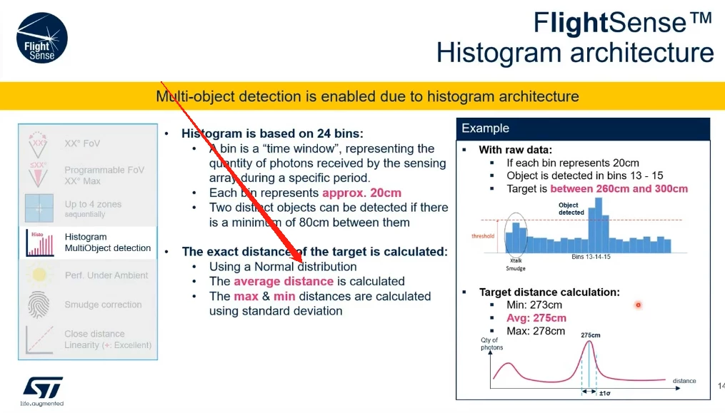

Yli.9
December 28, 2021
0693W00000HpxrWQAR.png@John E KVAM​ Hi,
I saw in a video (See the screenshot above) that the distance of target is extracted by assuming a normal distribution, so i am thinking is it possible to recover the histogram approximately from recevied values? As in L5 we cannot access histogram data directly, this maybe useful.
Do the received range sigma means the sigma of that normal distribution?
