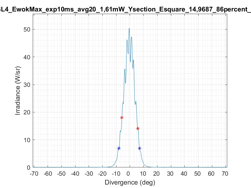

It would be very useful to be able to get some more information with respect to the irradiance of the VCSEL transmitter. I have to estimate  the intensity at 1 meter distance.

Please find below VCSEL power data for L4.
