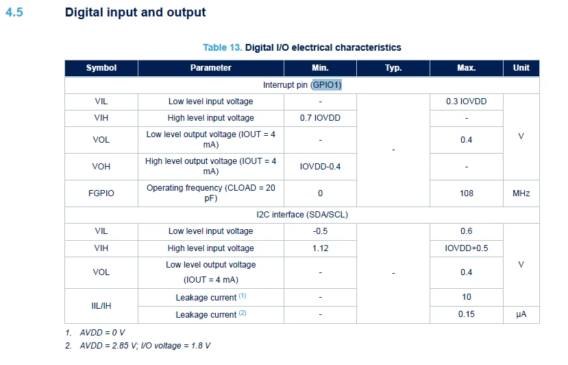

Query 3 : IO Voltage level
From the datasheet, IO level is mentioned either 1V8 or 2V8
I'm using the VCC of the sensor is 2V8 and rest all IOs (SCL,SDA,XSHUT,GPIO) in 1V8 level
Is there any issue in this.

For our design, we need to operate the SCL,SDA,XSHUT,GPIO1 at 1V8 level
As per your inputs, we can ignore the #ifdef USE_I2C_2V8.
I would request you to confirm that 1V8 will be applicable for all pins(SCL,SDA,GPIO1,XSHUT)

There are two power levels. AVDD (3v3) and IOVDD (typically 1V8)
XShut is tied to AVDD - so it needs to be 3v3 and it's a bit subject to noise. Should be clean.
GPIO is 70% of IOVDD when high.
