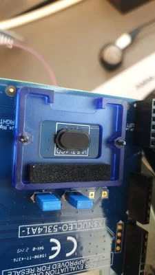

I am designing a product based on VL53L4CDV0DH/1 ToF sensor,
when purchased an evaluation board NUCLEO-53L4A1 It contains a small cover IR window
I want to use it in mass production,
There is off the shelf such IR cover ?
P/N ?

Best answer by EduardD
These are the parts from www.hornix.com.tw - the first 2 have flat pieces of glass that fit tightly over the sensor. Click on product to see the full list - near the bottom of the page.
The one on the right has an opaque barrier that completely prevents crosstalk - but it's more expensive to mold.
(Hornix and ST cooperate but have no financial arrangement.)
They are in Tiawan - so give them a bit to respond.
- john

EduardDAuthorBest answer
July 25, 2024
- john
EduardDAuthor
July 28, 2024
Thank you,
Will contact them
