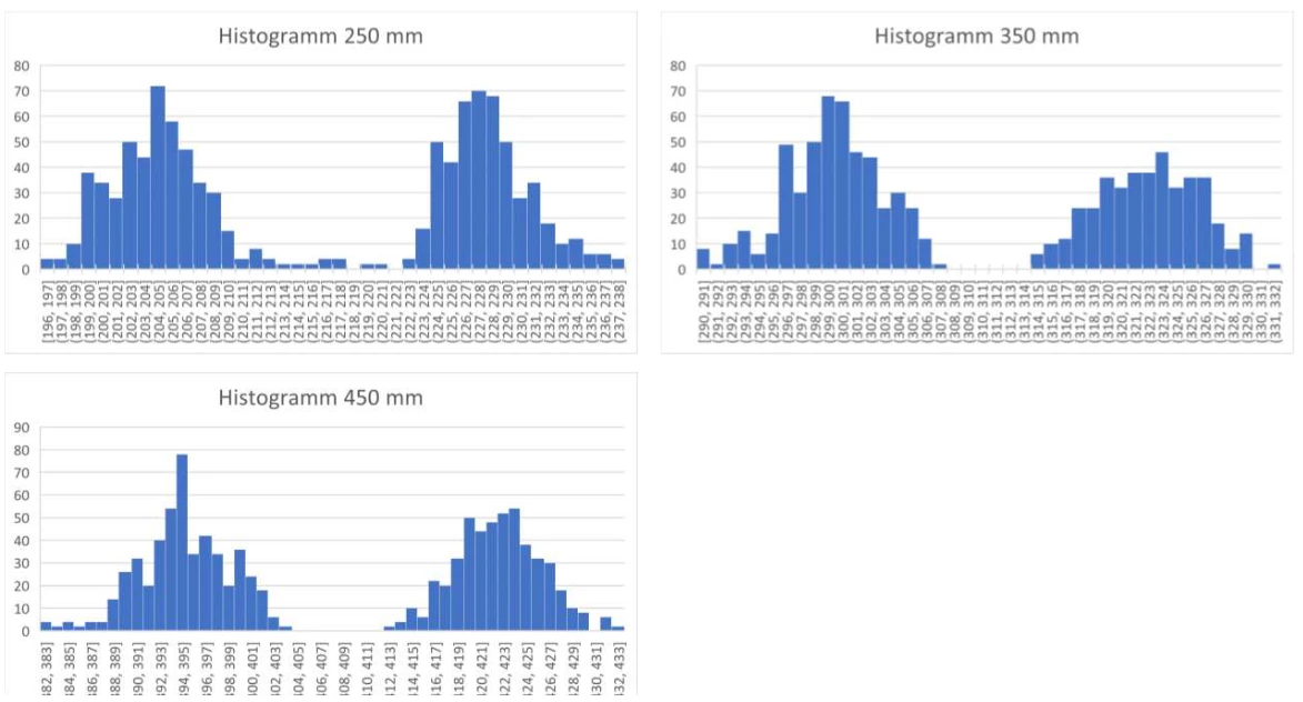

Thank you for the help! I have spent the day aquiring data and I can try to describe the issues to you.
First of all, the accuracy is the biggest problem. In my application there are 4 VL53L3-Sensors on one board. I am calibrating each on in the order refSPAD, XTalk with gray target @600mm and Offset per VCSEL with white target @150mm. After calibration, the acurracy is still pretty poor, I am experiencing linear offsets on two sensors and after calibrating many times and also trying different settings, I was not able to compensate that.
I will manually calibrate them and this should fix the biggest part.
Second, even if that is fixed, the accuracy is still not suitable for my application (get the orientation of plane targets up to a distance of 450 mm).
When changing the distance mode or the timing buget, this results in not finding a valid target and I always end up using something close to the default settings (distancemode medium, timing buget 10 ms at the moment).
Because of that limitation, I was wondering if there was more I could do.
The third issue I could see after aquiring some data, was that the measured distance of one sensor is somewhat odd distributed...
I coud provide you a screenshot of the histogram of a white target @250, 350 and 450 mm distance. X-Axis is measured distance, Y-Axis is how many times the range was measured, each one is result of ca. 1000 measurements.
Thanks again,
John E KVAM
March 22, 2021
Given the clustering of your data, I'm going to take a guess.
At each 'start' command the sensor does a 'phase detect'. and it sure appears that you are coming up in one of two phases.
(This guess assumes you didn't do one 'start' and a lot or ranges, but did at least a few 'start/stop' operations.
Find the parameter #define VL53LX_TUNINGPARM_PHASECAL_PATCH_POWER_DEFAULT in the VL53Lx_tuning_param_defaults and see if increasing it helps.
Try 2 to start.
Note - this WILL delay the time until first_range_complete as it spends more time calculating the range.
See if the data gets bettter and if you can live with the delay.
