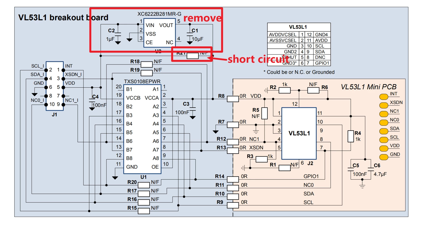

My main confusion is why there are still several mA of power consumption when the TOF rangefinder completes measurement and enters software standby mode. My MCU and TOF have separate, independent power supplies. Also, when using the ULD library, the power consumption after ranging completion and entering software standby is only a few μA, which is consistent with the manual. Therefore, I don't think it's an issue with my hardware connections.When I pull XShut low, it consumes about 400μA of current at 2.8V supply (all my power to the TOF is 2.8V)。I also made some modifications to the circuit, removing the voltage regulator chip and shorting R21 to get closer to the device's power consumption, but I didn't remove the level shifting chip because when I removed this chip, the TOF stopped working for some reason.
John E KVAM
Mar 27, 2025 3:32 PM UTC
I was completely confused until you mentioned 'level shifter chip'. Those things are the root of all evil. I know we need them sometimes, but they have caused me so much pain in the past that I've learned to hate them.
Do you really need it?
Certainly, if you are going a long distance, they help. Of if your MCU needs the 5V I2C, you are kind of stuck.
But the sensors I2C can handle I2C up to 3.6.
But can we try something:
(The VL53L1, L3, and L4s all have the same I2C interface.)
In the VL53L1 Sensor, there was a setting a bit of code in VL53L1_DataInit().
#ifdef USE_I2C_2V8
	Status = VL53L1_RdByte(Dev, VL53L1_PAD_I2C_HV__EXTSUP_CONFIG, &i);
	if (Status == VL53L1_ERROR_NONE) {
		i = (i & 0xfe) | 0x01;
		Status = VL53L1_WrByte(Dev, VL53L1_PAD_I2C_HV__EXTSUP_CONFIG,
				i);
#endif
And you need:
#define VL53L1_PAD_I2C_HV__EXTSUP_CONFIG 0x002E
 This changes the expected mid-point of the I2C - and thus the point it clocks the bit. As the mid-point between 0 and 3v3, is not that much different than the mid point of between 0 and 2v8, one can write the register. But this makes the I2C more reliable if using the 2v8 - which you use.
And it might help to get rid of the level translator - saving you a bit of money.
And I'm hoping it will save you that power drain as well.
- john
If this or any post solves your issue, please mark them as 'Accept as Solution' It really helps. And if you notice anything wrong do not hesitate to 'Report Inappropriate Content'. Someone will review it.

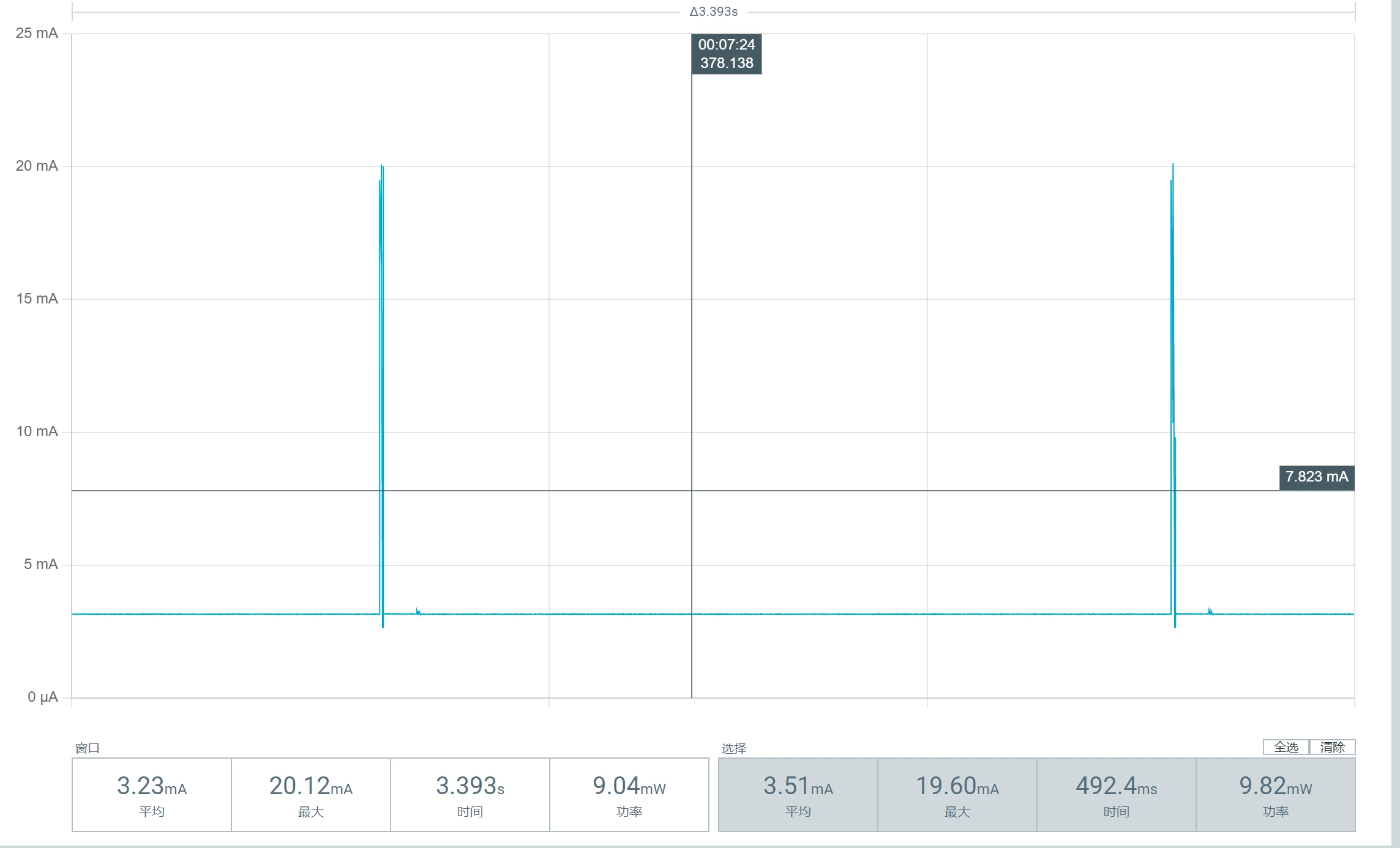

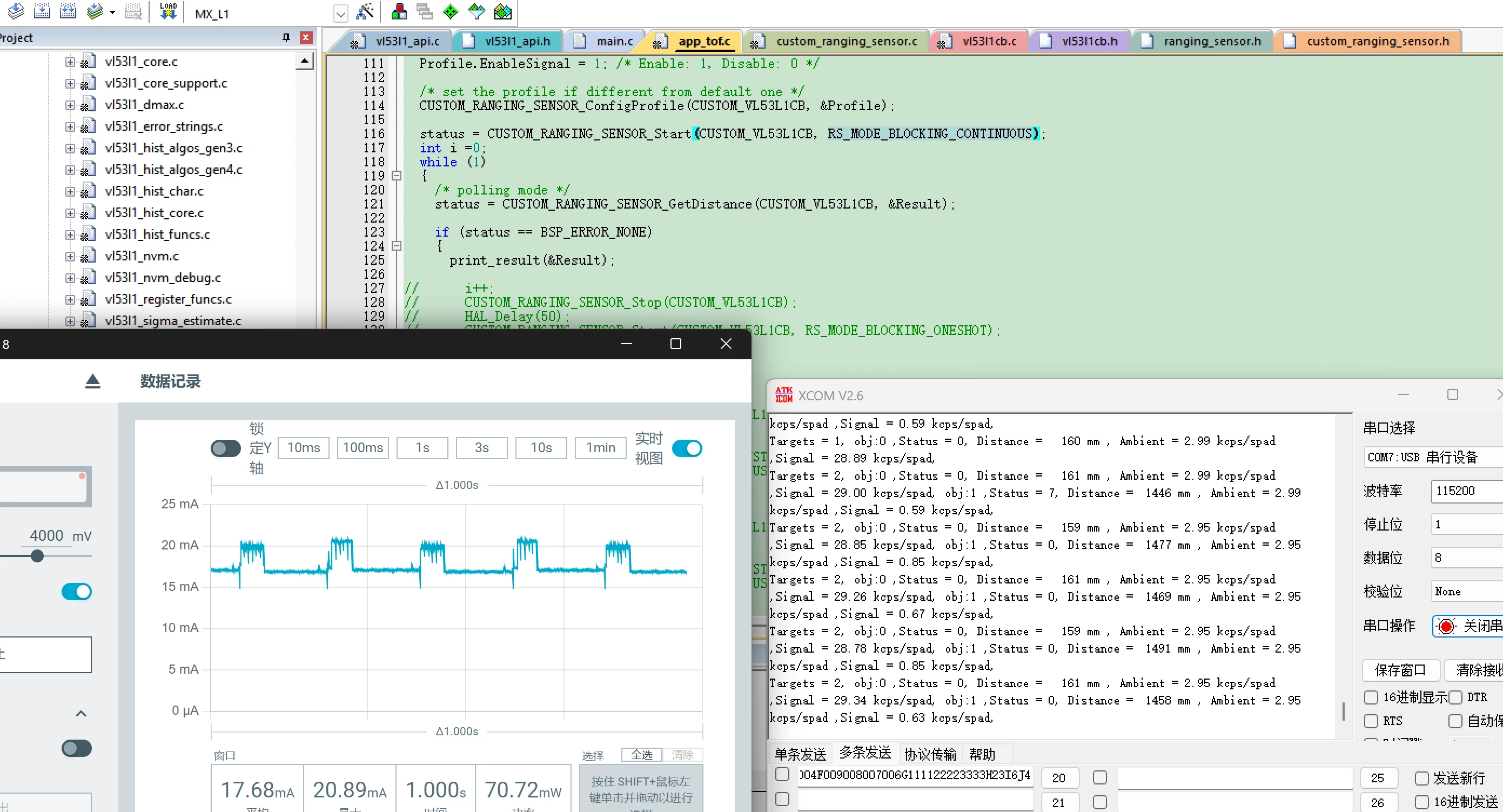

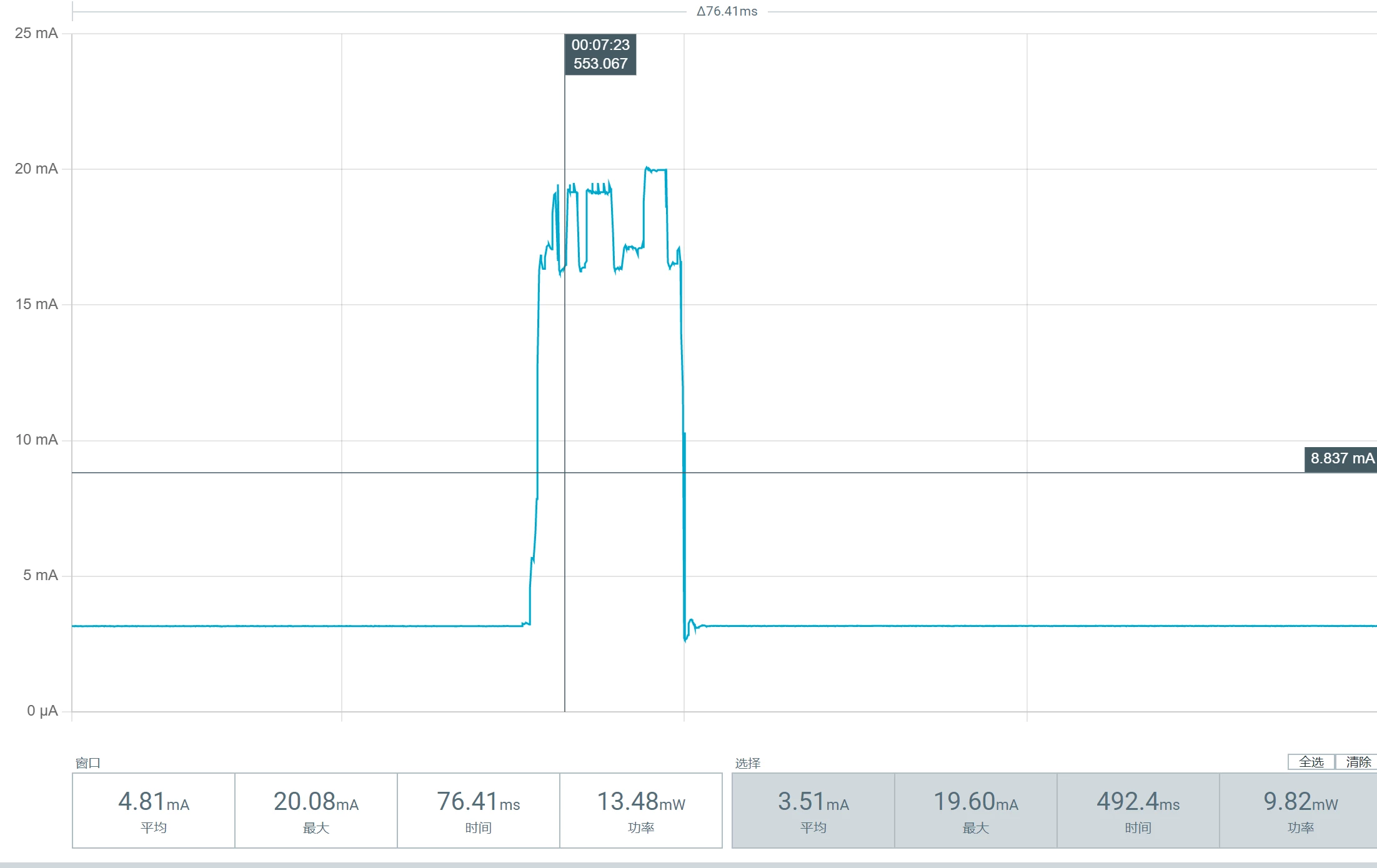

qqzlqqzlqqzl
Aug 25, 2025 5:48 AM UTC
This image shows the current curve during ranging. The configuration is a 50ms timing budget, a 50ms inter-measurement period, and long-range mode.
By tracing the function calls, I found that VL53L1_ClearInterruptAndStartMeasurement is already called within the VL53L1CB_GetDistance function. The ToF driver and the demo program were generated using CubeMX software.
As a side note, there is a significant difference in power consumption between different library versions.
John_KvamBest answer
Graduate
Aug 31, 2025 3:57 PM UTC
The CB code had an issue and it was decided to fix the issue with a patch to the code on the sensor. But that means that one has to keep the sensor alive enough to not lose the memory. And that is why the histogram parts do not go into their lowest power setting.
However, that patch is not used in the non-histogram parts. And it should be a lot lower than the 17ma shown in your plot.
And especially the ULP driver should get down to zero.
Could it be that you are measuring something in addition to the power used by the sensor? When I was doing this, I inadvertently was measuring some pull-up voltage. (I blame my software background.)
but if you power consumption is too high, ensure the interrupt is clear, and the I2C lines are both high. It's really all I can think of.
