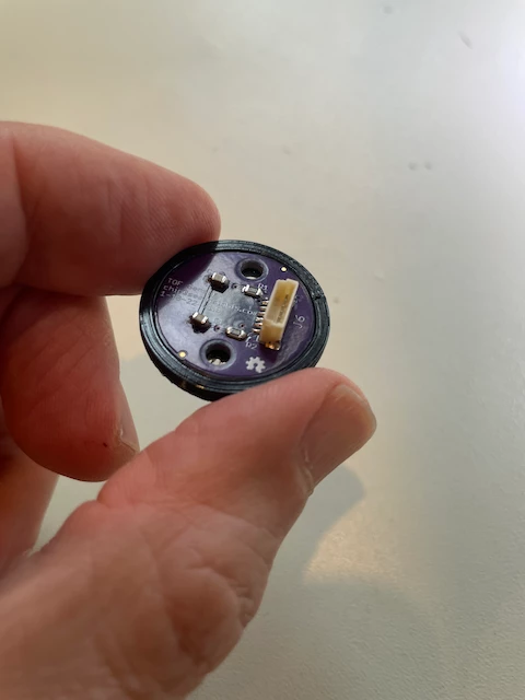

Vl53L1X sensor for outdoor applications - I understand direct sunlight is an issue. But what about other environmental considerations such as rain or snowfall?

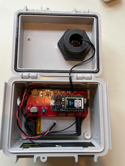

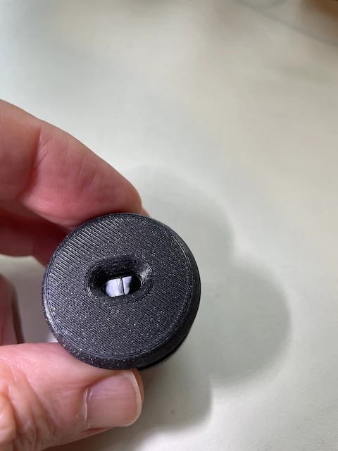

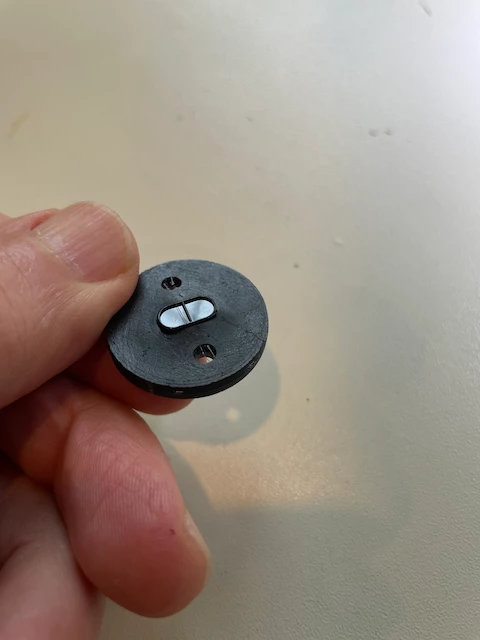

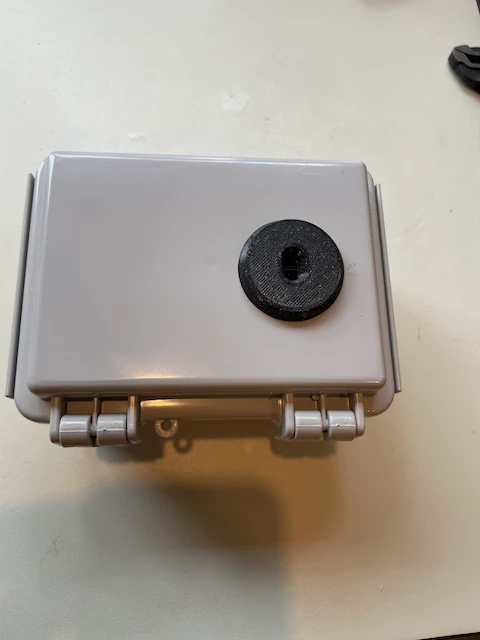

Thank you John. I am going to test this implementation that includes a lens cover from Hornix and a bit of an indent that should provide some shade. The application here is people counting in outdoor environments (likely to be shaded as they are in the woods).
