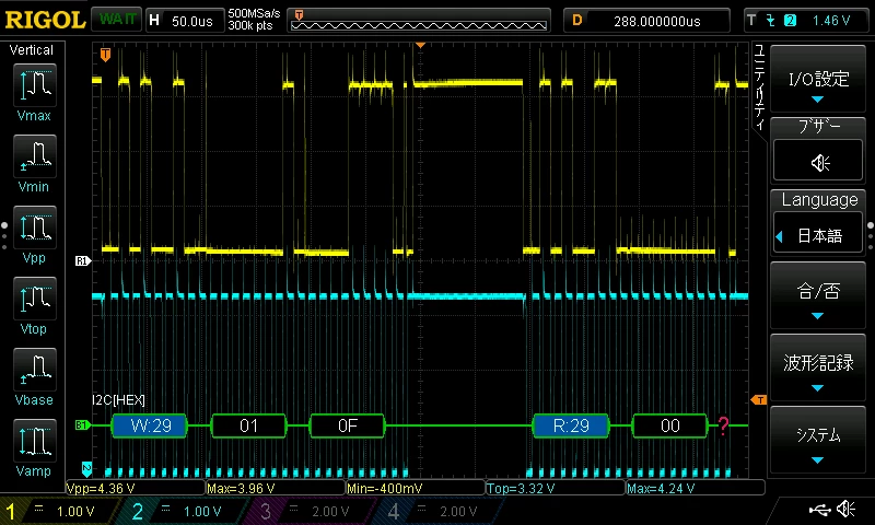

VL53L1X returns 0x00 instead of 0xEA on PIC18F16Q41 hardware I2C
I am trying to communicate with a VL53L1X sensor using a PIC18F16Q41 hardware I2C peripheral (MCC-generated driver).
The sensor module is AE-VL53L1X from Akizuki Denshi (Japan), which includes the original ST VL53L1X sensor and onboard level shifter.
Current issue:
The sensor ACKs correctly, but reading the Model ID register (0x010F) always returns 0x00 instead of the expected 0xEA.
Current I2C sequence:
START
W 0x29 ACK
0x01 ACK
0x0F ACK
STOP
(wait about 1 ms)
START
R 0x29 ACK
0x00 NACK (expected 0xEA)
STOP
What I already confirmed:
* Wrong I2C addresses correctly return NACK from the sensor
* XSHUT is correctly pulled up
* Sensor power is stable before PIC startup
* Oscilloscope confirms correct ACK/NACK behavior
Important comparison:
Using a RATOC USB-I2C converter with the same sensor module, register 0x010F correctly returns 0xEA.
So the sensor module itself appears to work correctly.
I compared the oscilloscope waveforms between RATOC and PIC.
One difference is the STOP timing generated by the PIC hardware I2C, but according to the VL53L1X datasheet timing requirements, it still appears to satisfy STOP timing specifications.
The attached SDA/SCL waveforms show some overshoot/ringing because the wiring is relatively long (about 50 cm total).
However, the same wiring length and similar overshoot are also present when using the RATOC USB-I2C converter, and in that case the VL53L1X correctly returns 0xEA from register 0x010F.
Therefore, the overshoot itself does not appear to be the root cause.
Has anyone experienced compatibility issues between VL53L1X and PIC18 hardware I2C peripherals?
Or is there anything special about VL53L1X register read timing/state handling that might explain why ACK works correctly but the returned data becomes 0x00?

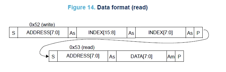

After checking the VL53L1X datasheet, especially Section 4 Control interface, the STOP condition between the 16-bit register index write phase and the read phase is valid and explicitly shown in Figure 14.
So, the issue does not appear to be STOP versus repeated START.

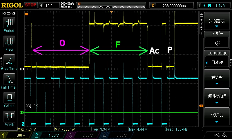

To further investigate your point regarding the STOP condition and possible register pointer/context handling inside the VL53L1X, I captured an enlarged oscilloscope waveform of the final part of the write transaction:
0x0F ACK STOP
This is the STOP condition generated by the PIC18F16Q41 hardware IC peripheral after transmitting:
W 0x29
0x01
0x0F
From my understanding, the STOP condition itself appears to satisfy the IC specification:
  • SCL is high
  • SDA transitions from low to high
However, I would appreciate your opinion:
Does this STOP condition waveform appear valid enough for the VL53L1X to correctly recognize the end of the write transaction?
Or do you see anything suspicious in this waveform that could prevent the device from correctly latching the register index before the subsequent read operation?
Thank you again for your support and technical insight.
Best regards,
Yasutoshi Oyamada
Aug 22, 2026 5:07 PM UTC
Hi:
From the waveform, the STOP condition itself appears to be electrically valid. In other words, SCL is high and SDA transitions from low to high.
the question is probably not whether the STOP is valid, but whether the slave sensor expects the register-address phase and the read phase to remain within one combined transaction. If possible, I would recommend trying a repeated START sequence from the PIC side, or comparing the exact RATOC read transaction at the protocol level to see whether it uses repeated START instead of STOP.
Best Regards,
Bin FAN
Hi Bin,
Thank you very much for your reply.
I agree that the STOP condition itself appears to be electrically valid.
I checked the VL53L1X datasheet again, and Figure 14 Data format (read) appears to show a STOP condition between the register index write phase and the following read phase.

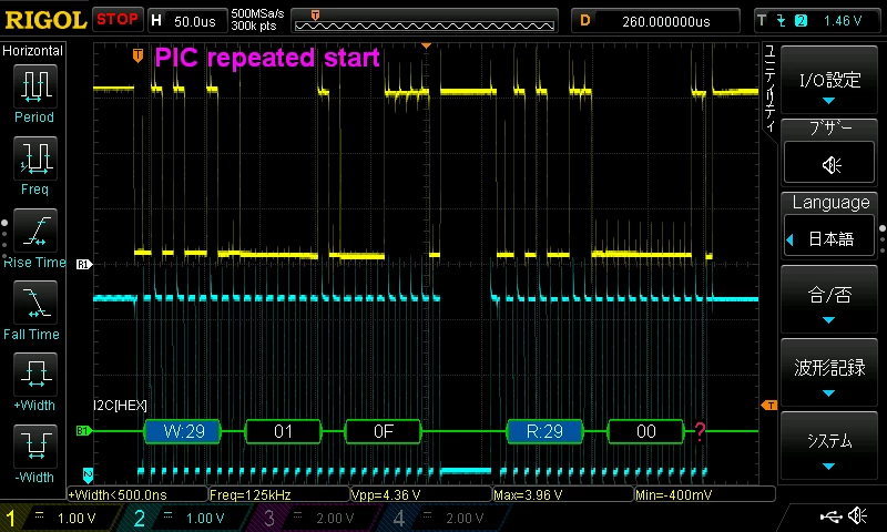

I also tried the repeated START sequence from the PIC side, but the returned data was still 0x00.

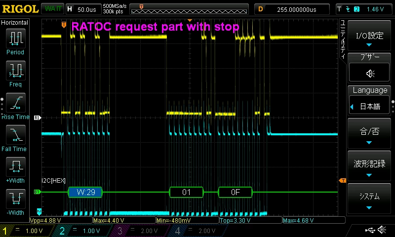

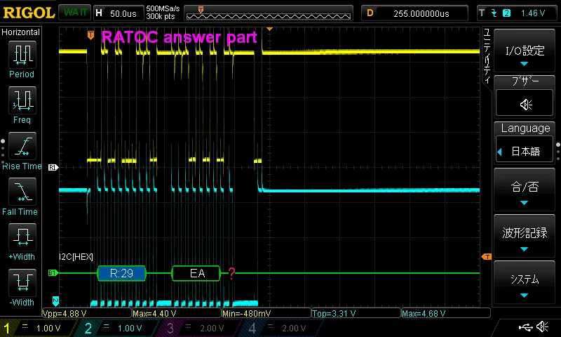

For comparison, I captured the RATOC USB-I2C transaction. The RATOC transaction appears to use a STOP after sending the register index:
W 0x29
0x01
0x0F
STOP
Then it performs the read transaction:
R 0x29
0xEA
So the RATOC converter can read the expected 0xEA value with a STOP condition between the write and read phases.
Based on this comparison, it seems that the difference may not be the STOP vs repeated START sequence itself, but something else in the PIC I2C transaction timing or bus handling.
I have attached the oscilloscope captures for:
  • PIC repeated START transaction returning 0x00
  • RATOC request phase with STOP
  • RATOC answer phase returning 0xEA
  • VL53L1X datasheet Figure 14
If you notice any important difference between the PIC and RATOC waveforms, I would greatly appreciate your advice.
Best regards,
Yasutoshi Oyamada4c084ce9-0858-a7a1-df5e-727dc426dffb.pngd39a76c8-87b5-9058-2601-877d60f092e2.png4cfdcb69-b53e-4d7d-c147-0e465d37dc3e.png60f17bb9-fe6d-8105-ff28-69544d2666c5.png

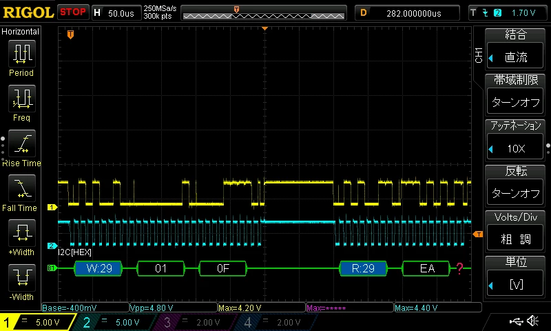

Aug 24, 2026 8:41 AM UTC
Hi Bin,
I would like to report the final resolution of this issue.
The root cause was not related to the VL53L1X communication protocol.
After further debugging, I found that an AI-generated initialization sequence contained a VL53L1X reset command, but the corresponding release-from-reset command was missing.
Therefore, the sensor remained in reset state.
This explains why:
* The device address was ACKed
* The register index bytes were ACKed
* The read address was ACKed
but register 0x010F always returned 0x00.
After removing the incorrect reset command, the sensor immediately became operational and register 0x010F returned the expected value 0xEA.
No special delays, clock stretching handling, or protocol modifications were required.
The attached oscilloscope capture shows the successful read transaction.
Thank you very much for your assistance and analysis. Your comments helped me confirm that the issue was likely outside the VL53L1X protocol itself and encouraged me to continue investigating the software side.
Best regards,
AndyO
