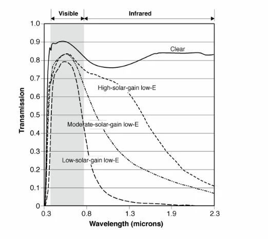

Hi, I am an embedded developer.
It was mentioned that it was used as a reverse sensor or even a drone landing sensor, so I immediately tested it with Aduino.
The result was failure.
Modifying parameters inside short and long modes does not work in external natural light.
"ambient light 200 kcps/SPAD = Short 1300mm" within the data sheet
There's this part, but this is an inside story of an office with sunlight outside the window.
John E KVAM
December 16, 2019
​It's a signal to noise problem. The eye-safe laser is only about as bright as an indicator LED. In sun-light the SPADs get saturated with the sunlight and simply cannot 'see' the signal.
The sensor's light is 940nm and thus invisible. But the sun generates a  huge amount of 940nm completely screwing up your results.
In modern buildings, low-e glass is used and that blocks an awful lot of non-visible light.
Your results show that your glass may be more toward the clear spectrum in the graph below.
(From https://www.efficientwindows.org/lowe.php)
We are looking at the issue, but the only solution appears to be a lot more SPADs (so they don't saturate). And of course that's expensive.
