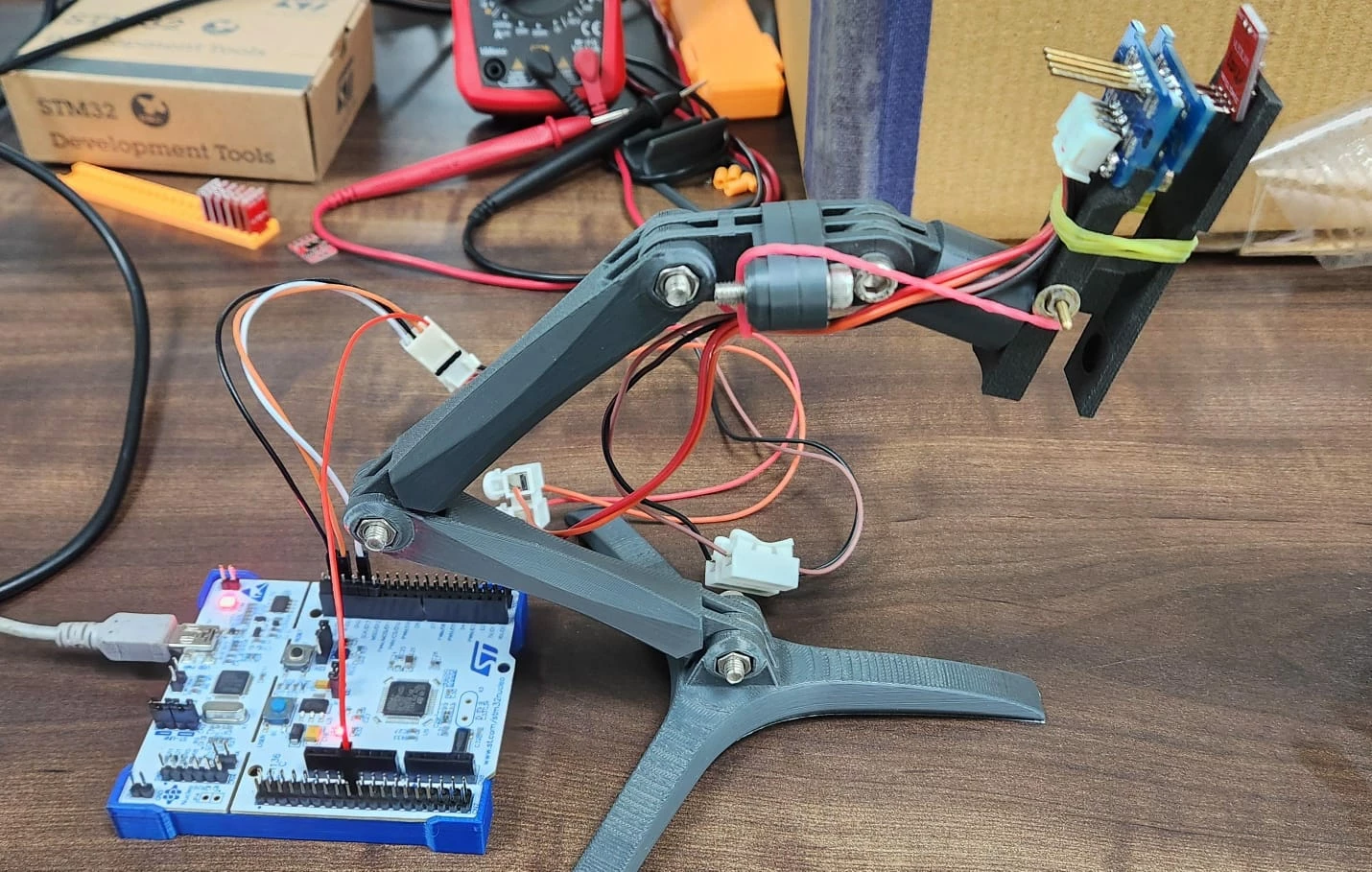

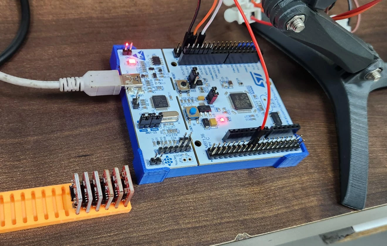

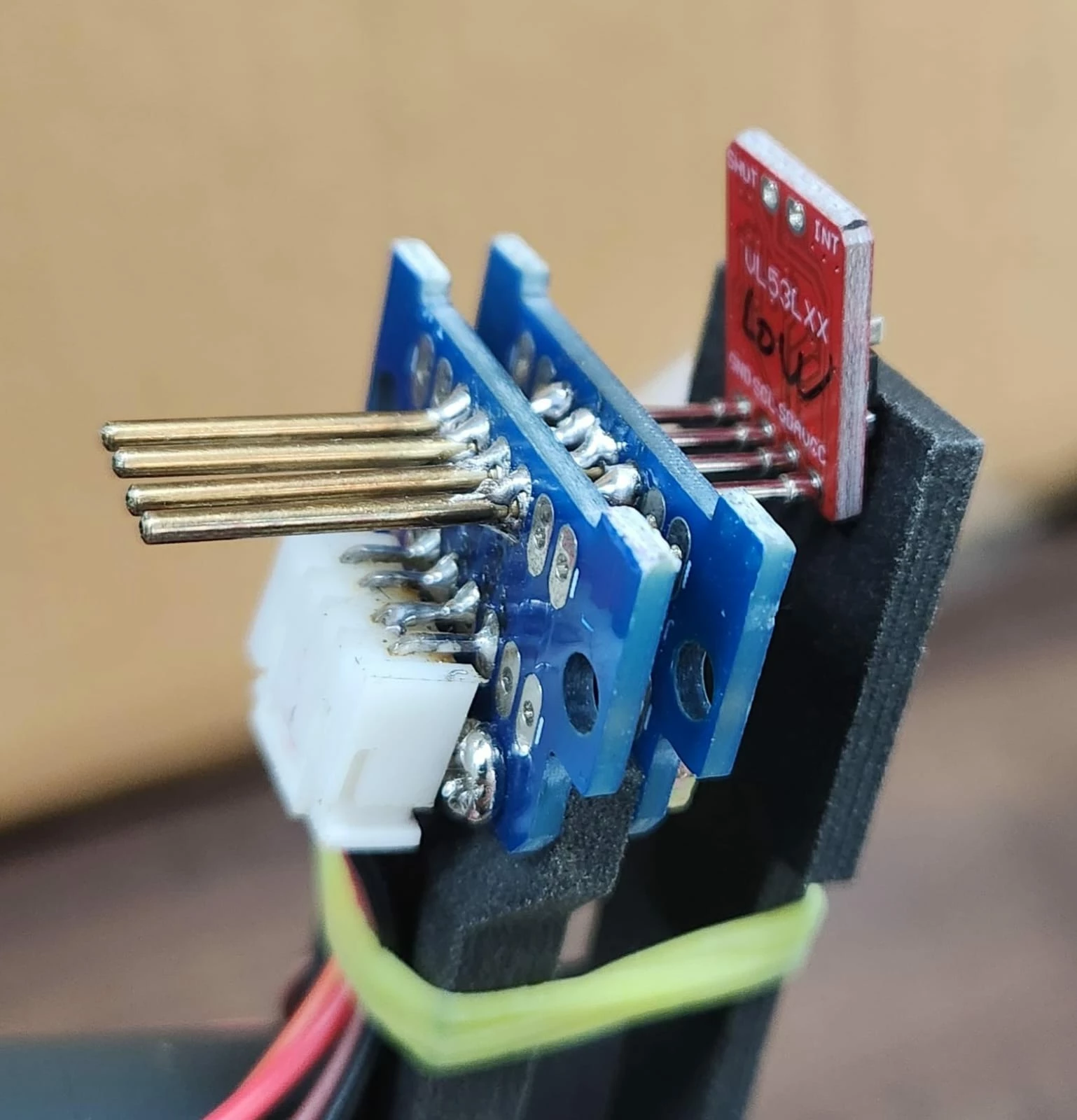

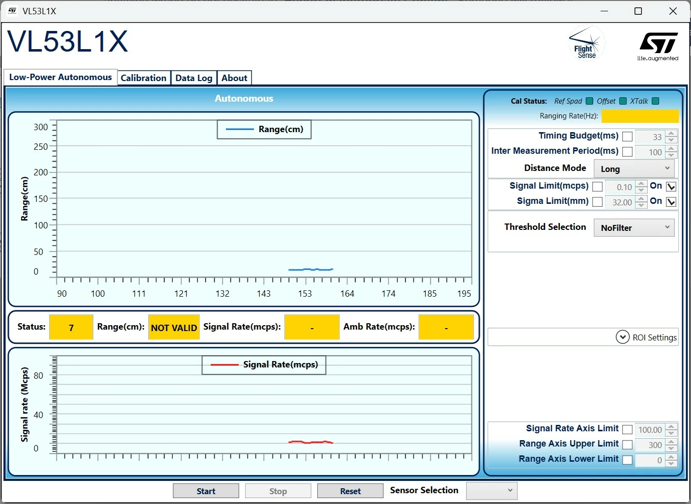

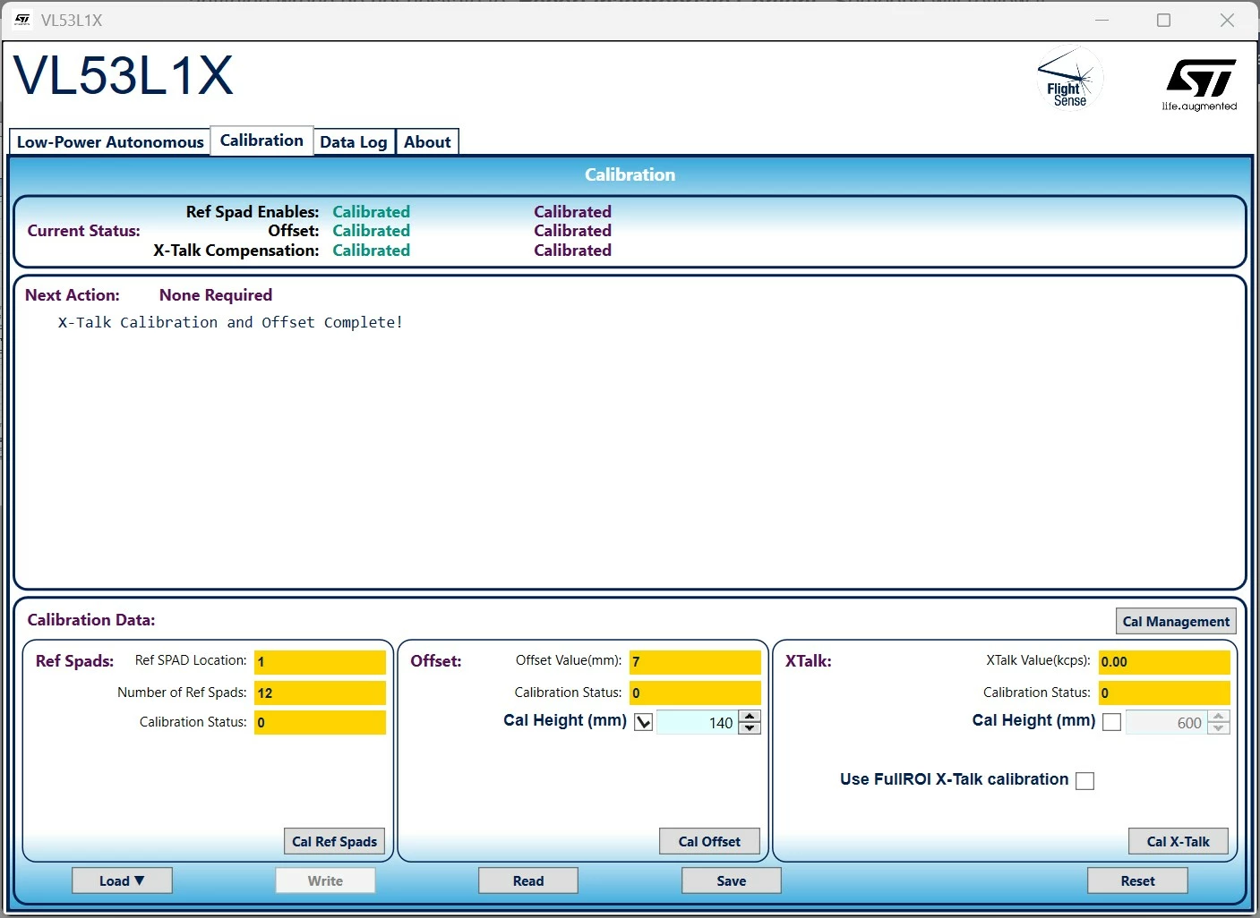

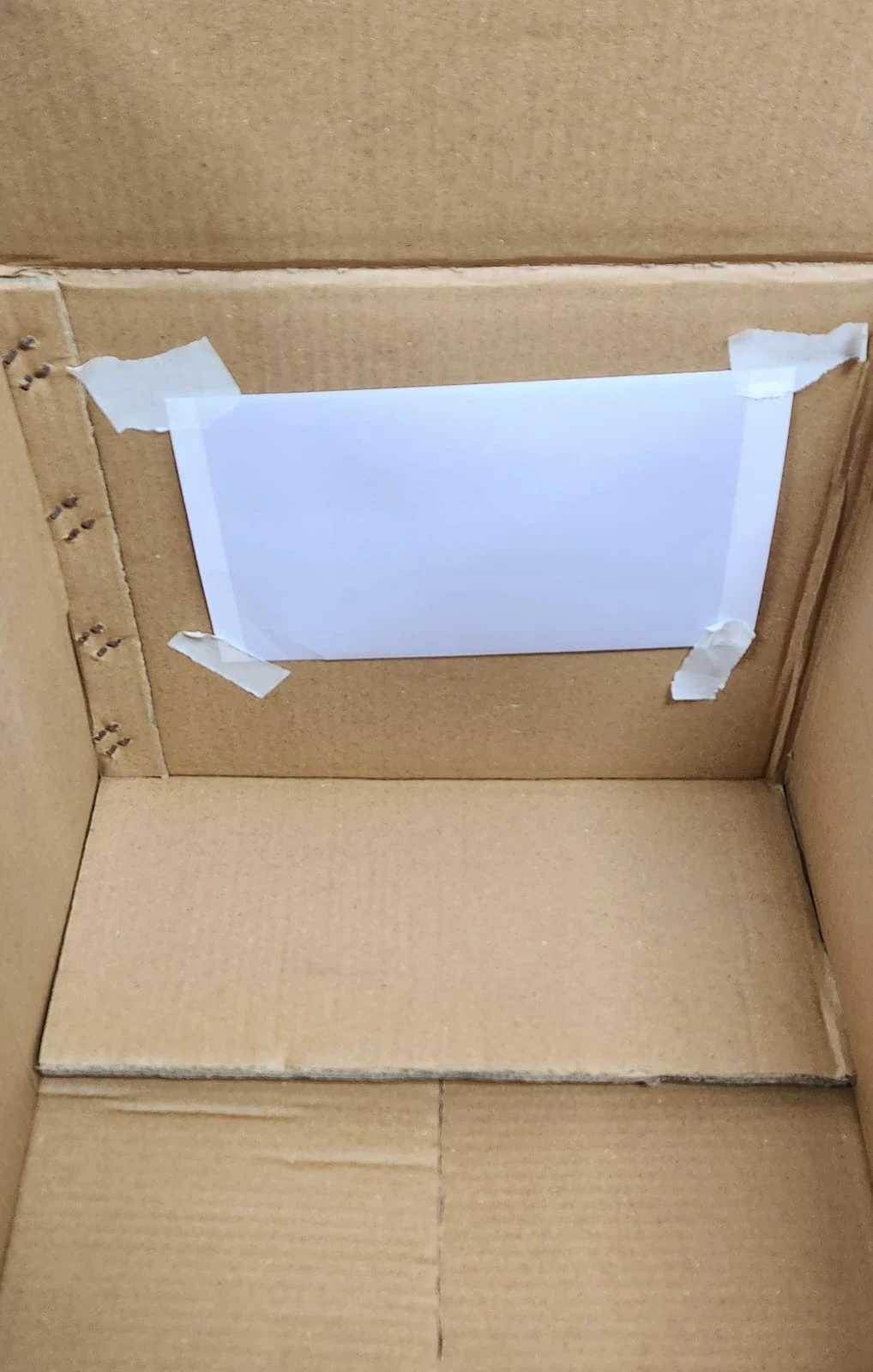

I went through various of your replies to people having issues with this sensor and decided to try recalibration with ST's software. I hooked it up to a Nucleo board and recalibrated in a dark box with the sensor at 140mm from a 17% gray sheet as recommended in the manual.
Please advise on the correct calibration procedure in case I am doing something incorrectly. I have attached photos of the setup and software screenshot.
What I have noticed is that that the sensor can detect a white sheet at 50cm in Short mode, 30 cm in Medium Mode and 18cm in Long mode. I find this very strange, perhaps this could shed some light on what's going on?
Q: Does the sensor need a calibration in 3 modes separately?

Use white paper at 140 cm to do the offset correction.
Use the dark gray or black to do the crosstalk correction. Distance is highly dependent on your coverglass. Do some experiments - range until you find that place where you are under-ranging by 10 or 20%. Then do the crosstalk from that distance.
In your case without a coverglass you should not have anywhere you are under-ranging. If you do, your sensor has an issue.
If you cannot range beyond 40cm, you either still have the Kapton tape on, or there is debris on the filter.
Double check for the tape.
Do the calibration, then clean your filter. use a gentle chemical. Just water, maybe a little alcohol in it. Maybe some ammonia, but go easy. The do the calibration again.
Does anything change?
- john

We can assume something is wrong. So, let's do an experiment.
Take a good sensor and range on something.
get the signal strength and number of SPADs.
Then take a 'bad' sensor and do the same thing in EXACTLY the same.
If you conclude you are getting 20M photons and using 62 SPADS on a good sensor and are only getting 10M photons using 162 spads then we know that there is not as much light returning from the target.
Two ways to make this happen. A blockage on the transmit side, or a blockage on the Receive side. In a naked sensor this is hard to do. With a coverglass or with an obstructed housing it's easy.
Is your sensor installed - or out in the open?
in your picture, could it be that the black object be covering part of the Field of view?
Re-adjust the sensor so that black bit is well away from the sensor. The light goes out in a code of 27 degrees, but there is roll-off at the edges. Perhaps that holder is reflecting and making a mess.

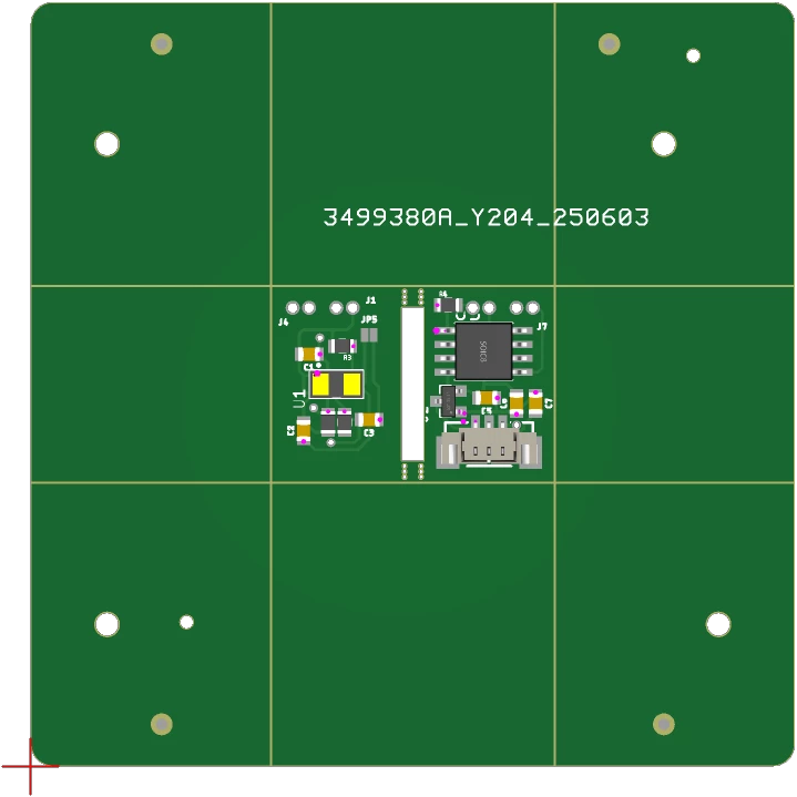

After having tried everything, I have put this on hold as we are way close to our delivery deadline. If this is the case I am sure many people will bring this up in the future, maybe a solution can be found then. For Now I have designed a custom board with the components and await its delivery. Thank you for all your help, If a solution is found, I will let everyone know.

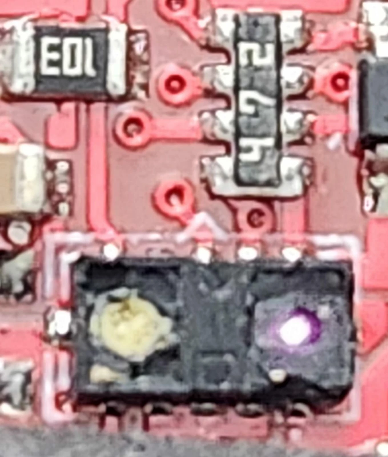

June 5, 2025

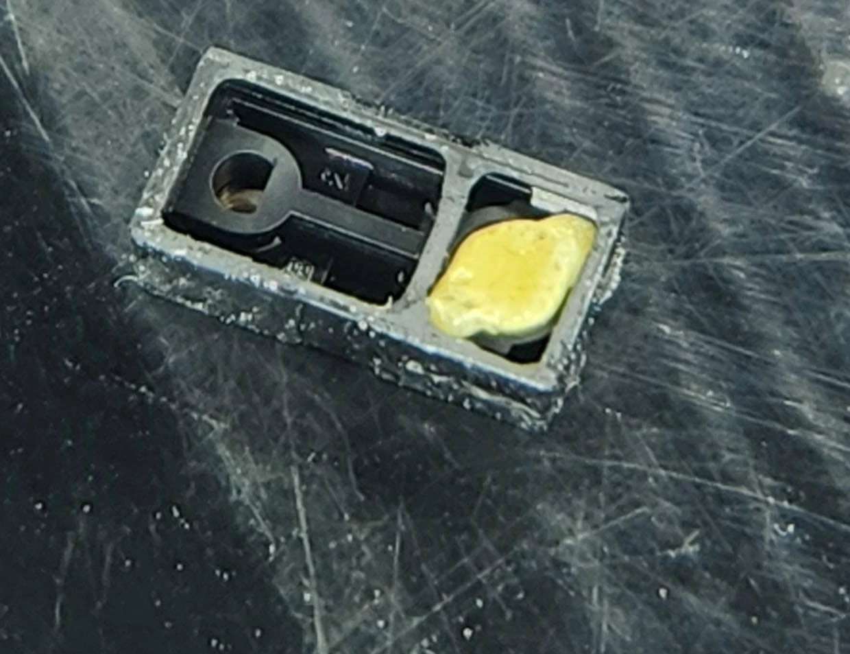

I removed the protective glass on one of the faulty sensors, The laser Cavity seems ok but the SPAD side has some resin in it, is it normal? Or it it flux that should not be there?  have we found the fault?
Photo attached.

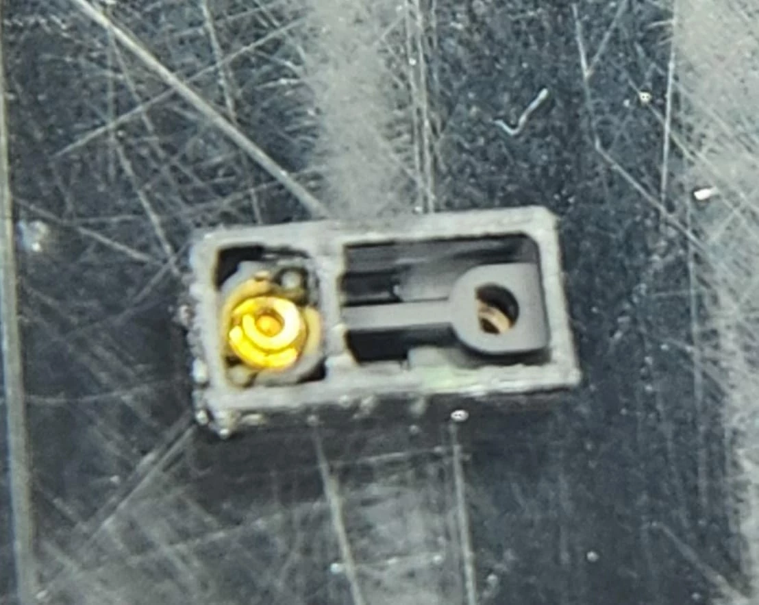

June 5, 2025
Bad Sensor
Good Sensor:
This is not flux, the optical lens on the SPAD side seems to have transformed into an opaque solid. Like cataract, Its either age or excessive heat. The mystery has been solved.  Its amazing how this sensor seems to work up till half a meter even when in such a condition. Can I claim this as a warranty issue? :D
