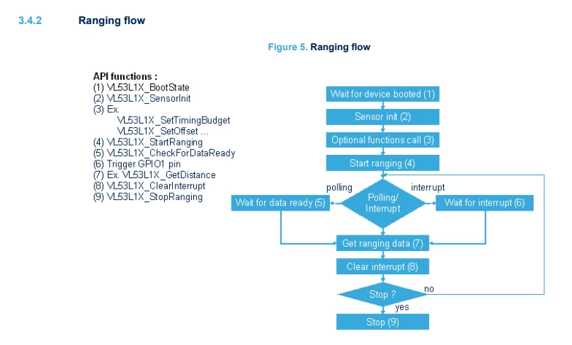

Question;
Looking at the "Ranging flow" diagram (in UM2510),
if I'm using "VL53LX_SetDistanceThreshold" with detection condition to be "Object within a window",
Do the interrupt triggers when an object comes within the window?
Or does the interrupt triggers Autonomously ?

I'd do it this way.
Write your code without the thresholds.
Prove it ranges and you can get the data.
if you have a non-iPhone or can use your laptop camera, you can see the flash of light. (Iphones have really good IR filters, so they will not see the light).
The sensor will continue to range even if you don't read the answer.
Then re-write your code and insert the set_thresholds, and your window.
You will see that you only get an interrupt when an object comes within your window.
So to answer your questions:
You will get the interrupt after the range occurs with an object within the threshold window
Or does the interrupt triggers Autonomously?
The sensor will run completely autonomously giving an interrupt only when your thresholds are met.
