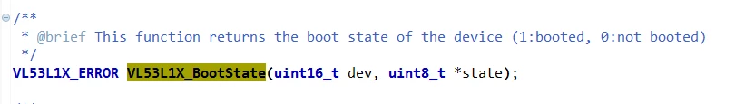

And as VL53L1X_api.h says:

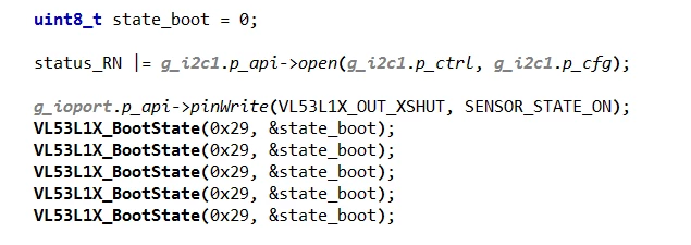

I have done all of the above John said except ranging. This is my code (my code is located at the beginning of the FIRST thread of the program, so It is the first thing to be executed after the internal MCU initializations).
These are the values of the five calls to "VL53L1X_BootState()" :
Write: 52 00 e5
Read: 53 02
Write: 52 00 e5
Read: 53 02
Write: 52 00 e5
Read: 53 03
Write: 52 00 e5
Read: 53 03
Write: 52 00 e5
Read: 53 03
So, my questions are:
  1. Am I doing something wrong and that is why I get wrong boot states?
  2. If my code is correct, could it be that the documentation was wrong?
Maybe 0x02 = No booted and 0x03 = booted?

John E KVAM
September 16, 2020
It sure looks to me like the LSB is the 'booted' flag. And what the other bit is still in question.
[0] firmware_bootup: FW initial boot status, Set by FW after completing initial coldboot."
So the LSB is as advertised. It's 0 until booted and then 1.
One might surmise that the other (first_range) bit might turn off after the first ranging.
Really should look at that.

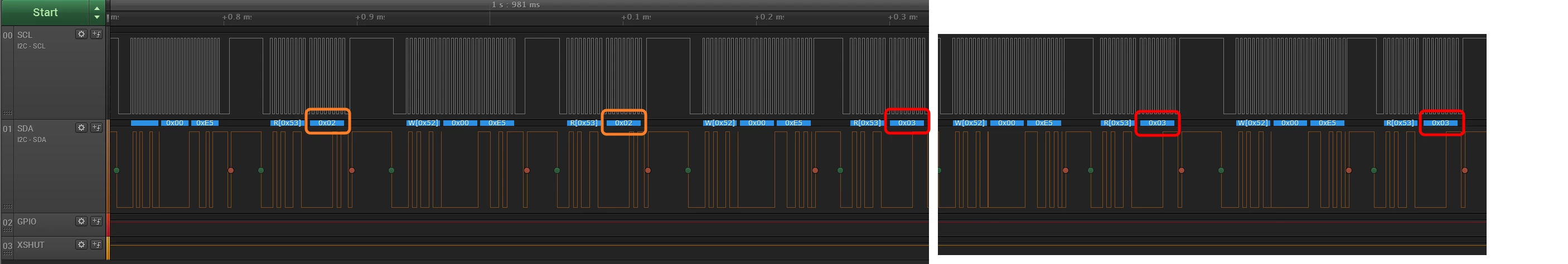

After waking up the sensor I check the first bit ([0] firmware_bootup) for a while, looking for value 1. There are two possible situations:
1) There's no delay between XSHUT=ON and VL53L1X_BootState. The secuence is:
Write: 52 00 e5
Read: 53 02 (0000 0010)
Write: 52 00 e5
Write: 52 00 e5
Read: 53 03 (0000 0011) --> Sensor booted
Write: 52 00 e5
Read: 53 03 (0000 0011)--> Sensor booted
Write: 52 00 e5

Visitor II
November 6, 2024
Note that in case of receiving 0x02 the target does not acknowledge index 0xE5 and thus we cannot be absolutely sure that the 0x02 we received is related to the register being read.
