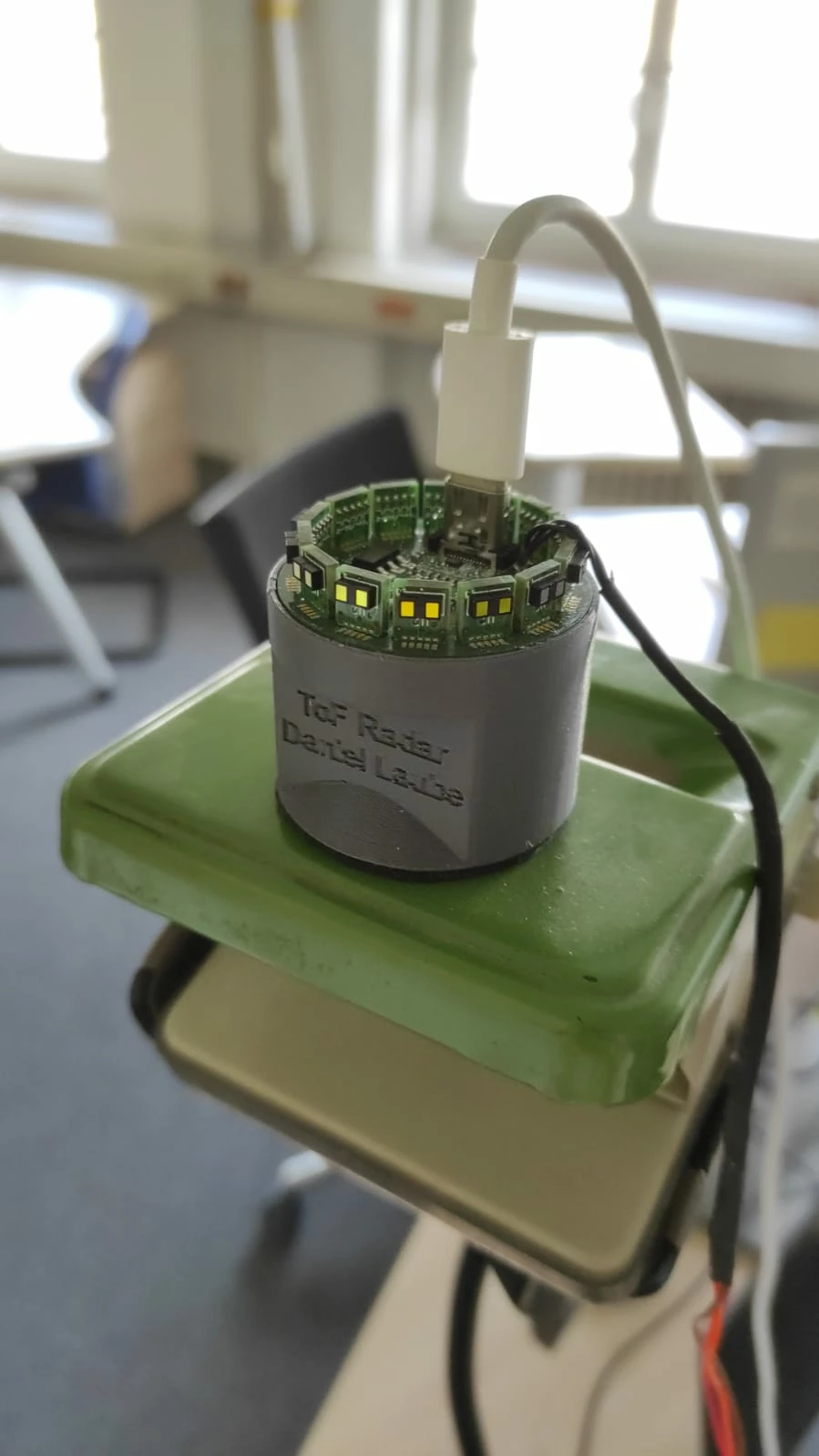

Here is the physical sensor layout, there are 14 sensors in a circle, so they are not overlapping that much.
0693W00000AMmdPQAT.jpgThe flickering and ranging issue persist, even if there is only one sensor ranging. The ROI setup is like this, they are overlapping. In the example video they are all ranging simultaneously, but only running one does not make a difference.

dlux
dluxAuthor
April 29, 2021
Perhaps i get something wrong but the numbrr of spads should not be changing when ​using the same ROI. About 50 spads for a 8x8 seems reasonable when there are 200 spads in total.
But periodic changing to 5 spads is very odd.
Do you know any reason why there are sometimes only 5 spads?
The flickering behaves the same when only using​ rangestatus = 0 readings. The video shows the rangestatus (indicated by color, green is RangeStatus = 0, cyan means RangeStatus = 14 and black is RangeStatus = 7. Other colors represent other RangeStatus values but they are not part of the flickering issue.
Dont get me wrong, i did not expect a range results up to 8m using when using a smaller ROI, but i kind of expected stable results < 4m for things like walls.
I can arrange myself with the "low" distance, but no reliable results (espacially such flickering/waving motion, indication that every second measurement is invalid) seems very odd to me.

Another follow up with more measurements:
I filtered the measurements to show only the largest roi from one sensor (facing to the wall). Using 500ms budget now.
Sensor: 7 ROI: 9 Ambient: [31744, 4294967295, 4294967295, 4294967295] EffectiveSpad: 16.4375 Range: [8191, 65535, 65535, 65535] Status: [255, 255, 255, 255]
Sensor: 7 ROI: 9 Ambient: [33792, 4294967295, 4294967295, 4294967295] EffectiveSpad: 206.5625 Range: [65419, 65535, 65535, 65535] Status: [12, 255, 255, 255]
Sensor: 7 ROI: 9 Ambient: [33792, 4294967295, 4294967295, 4294967295] EffectiveSpad: 206.5625 Range: [3729, 65535, 65535, 65535] Status: [4, 255, 255, 255]
Sensor: 7 ROI: 9 Ambient: [33280, 4294967295, 4294967295, 4294967295] EffectiveSpad: 206.5625 Range: [65419, 65535, 65535, 65535] Status: [7, 255, 255, 255]
Sensor: 7 ROI: 9 Ambient: [33280, 4294967295, 4294967295, 4294967295] EffectiveSpad: 206.5625 Range: [3733, 65535, 65535, 65535] Status: [4, 255, 255, 255]
Sensor: 7 ROI: 9 Ambient: [34304, 4294967295, 4294967295, 4294967295] EffectiveSpad: 206.5625 Range: [65425, 65535, 65535, 65535] Status: [7, 255, 255, 255]
Sensor: 7 ROI: 9 Ambient: [34304, 4294967295, 4294967295, 4294967295] EffectiveSpad: 206.5625 Range: [3726, 65535, 65535, 65535] Status: [4, 255, 255, 255]
Sensor: 7 ROI: 9 Ambient: [34304, 4294967295, 4294967295, 4294967295] EffectiveSpad: 206.5625 Range: [65418, 65535, 65535, 65535] Status: [7, 255, 255, 255]
Sensor: 7 ROI: 9 Ambient: [34304, 4294967295, 4294967295, 4294967295] EffectiveSpad: 206.5625 Range: [3736, 65535, 65535, 65535] Status: [4, 255, 255, 255]
Ambient seems rather low (its the raw value, not divided by anything). EffectiveSpad count seems also okay (like you mentioned about 200 spads with full roi).
The measurements cycle between RangeStatus 4 and 7. 7 Gives a pretty accurate result with about 3.7m, but i dont get why every second measurement is considered "VL53L1_RANGESTATUS_OUTOFBOUNDS_FAIL".
Another video of the issue that every second measurement of a ROI is not valid: Flickering 2 - YouTube
there you clearly see the 3x3 + 1 Grid appearing slowly and then vanishing again. I don't think that this is an expected behaviour. At least i can't think of a reason.
