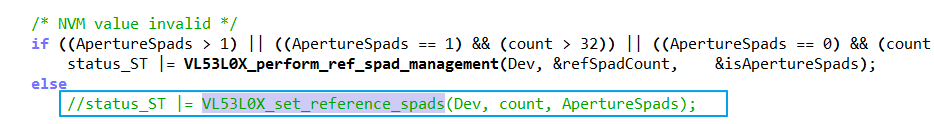

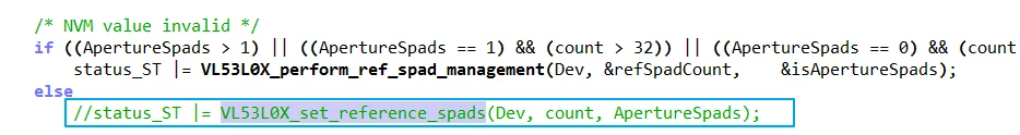

Hello, I'm using a VL53L0X and it returns 0x1FFFF depending on whether a function within "VL53L0X_StaticInit" is commented or not during initialization.
If "VL53L0X_set_reference_spads" is commented, the sensor sends values (with a large offset). But, if "VL53L0X_set_reference_spads" is not commented, the sensor sends 0x1FFFF all the time.

​Hi ,
We recommend you do not modify the basic functions of the driver.
To correct the offset error, you have to call the offset calibration function once the VL53L0X_StaticInit() function is called.

Hi Julien, thanks for your answer.
Sorry, I think I explained it wrong.
My main problem is not the offset (I will use the function "VL53L0X_PerformOffsetCalibration" as you suggest to correct it).
My problem is within the "StaticInit" function. I don't want to modify the API that ST gives me, but the thing is that without modifiying the library, the sensor doesn't work (sends 0x1FFFF all the time). The VL53L0X only does something when I comment "VL53L0X_set_reference_spads" (I figured it out by trial and error).
That's why I asked if this problem was related to this other "initialization problem" thread. I'd like to know if it's an internal sensor problem or has to do with my program.

The function "VL53L0X_set_reference_spads" returns 0 all the time. This function sends the following frames:
  • 56 FF 01
  • 56 4F 00
  • 56 4E 2C
  • 56 FF 00
  • 56 B6 B4
  • 56 B0 00 F0 FF 01 00 00
  • 56 F0 /// 57 00 F0 FF 01 00 00
When I request distance measured, I get the following all the time:
  • 56 14 /// 57 21 06 BF 04 00 00 00 00 00 00 1F FF
The strange thing comes when I change the "local Status" variable to a "volatile local/global Status" variable (I only make this change in my code). In this case, sent frames are the same as before (56 FF 01, 56 4F 00, etc) except for the distance:
  • 56 14 /// 57 5B 06 1B 04 2C 1C 0B 30 00 12 00 5D
  • 56 14 /// 57 5B 06 18 04 3C 80 0B EE 00 0E 00 5E
  • 56 14 /// 57 5B 06 BF 04 01 C2 04 47 00 AC 01 09
As you can see, now the sensors detects my hand movements.
Any idea?
[EDIT] It seems that the weird "volatile trick" only works sometimes, so there must be something else I don't understand.
Anyway, the problem related to commenting or not commenting the function "VL53L0X_set_reference_spads" is the same: the sensor returns 0x1FFF if not commented, and real distances if commented.

The only thing I can think of is you somehow got bad reference SPADs when you first calibrated and called the "VL53L0X_get_reference_spads", so when you set them after the next boot, you make a mess.
Is it possible?
