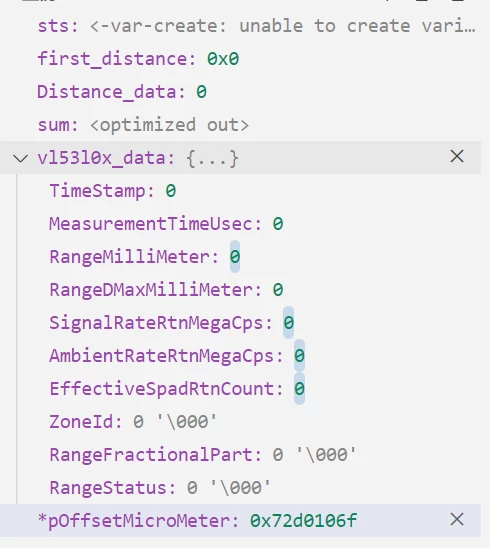

   follow  can  make offset calibration?Place the object 14cm away .Must be in a dark environment?

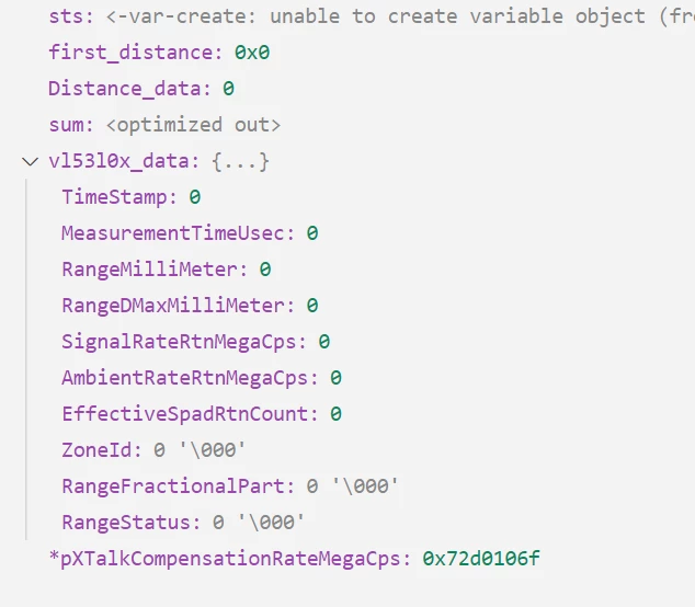

follow can make Crosstalk calibration?   Place the object 60cm away.

About offset calibration, normally we suggest do offset calibration at short distance(10cm or 14cm) with white target (88% reflectance) in dark condition.
About xtalk calibration, can you share your ranging data in dark condition? normally we suggest do xtalk at reorted distance start to drop, refer below picture.
And you shared ranging data is under the sun, VL53L0CX ranging ability will decrease with IR noise increase, as sun also contain 940nm noise, so sun light will impact VL53L0CX max ranging ability

  follow is offset calibration value:14cm
follow is talkcross calibration 60cm  not under sun

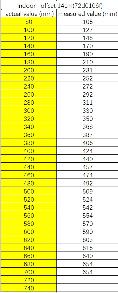

  I positioned the glass cover in front of the sensor and performed offset calibration at 14cm. The actual and measured distances are as follows. Where should I perform the CROSSTALK calibration?

Hi
From the data seems your calibration is not succeeded, or you forgot set the offset value after rebooting, normally after doing offset, if you do range measurement, the reported distance will be around 140mm, but your measurement data is 170mm.
Anyway, from your test result, I suggest you do xtalk between 650~700mm.

Hi,dear Han
  every power up ,I must run
VL53L0X_Error VL53L0X_set_offset_calibration_data_micro_meter(VL53L0X_DEV Dev,
        int32_t OffsetCalibrationDataMicroMeter)
