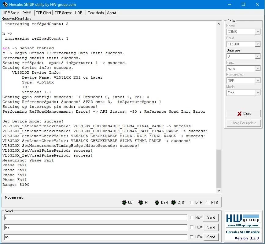

Thank you for your (1st) reply. Here is what I observe:
Only these values returned VL53L0X_ERROR_NONE from VL53L0X_SetReferenceSpads call (refSPADCount, isAperture):
  • (0,0)
  • (0,1) - (1,1) - (2,1) - (3,1) - (4,1) - (5,1) - (6,1) - (7,1)
I took 44 as max refSPADCount. So within the aperture and non-aperture values, only these values resulted without error.
If I do VL53L0X_StaticInit after VL53L0X_SetReferenceSpads, the VL53L0X_StaticInit call sets refSPADCount and isAperture values to: (0,0) always.
If I put VL53L0X_StaticInit before VL53L0X_SetReferenceSpads then refSPADCount and isAperture values is read as they are.
Whatever I do VL53L0X_PerformRefSpadManagement always returns -50 : Reference Spad Init Error.
However, if try to use DF-Robot arduino library, the sensor works with a 10 mm offset. When I look at the sensor with a cellphone cam, I can see the light emitted from the sensor. But no luck with the STSW-IMG005 library. I could not be able to see the light also with a cam. No methods are working as shown on examples.
Here is an example output of the firmware that I use:
We are designing a product based on the VL53L0X. We have invested a lot, and I would like to make the sensor work with the supplier supplied library not with a reverse-engineered one. Would you please help / assist me digging the reason?
Thank you in advance.

Another approach is to edit out the error checks and get the device to run. I've been told the first few ranges will be bad. After that the sensor self corrects and runs successfully. Or just not do the RefSpad calibration and burn a dozen or so results.
