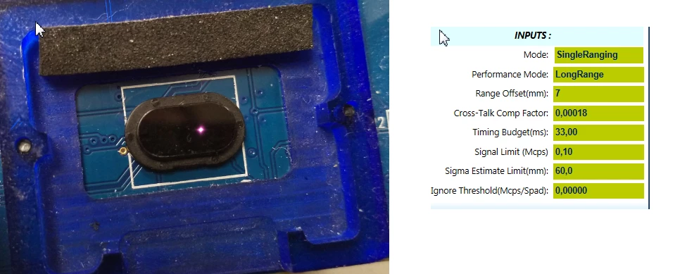

Hardwariano
Jul 20, 2020 7:48 AM UTC
Hello again
I tried different distances as Julien suggested but the problem persists. I also checked the cover and the sensor as John suggested but I didn't find anything.
Then, I placed the SAME sensor cover on X-NUCLEO-53L0A1 and used VL53L0X GUI from ST to calibrate the NUCLEO's sensor: It worked really well (offset = 7mm and xtalk = 0.00018).

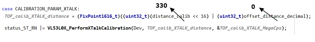

Seeing this, now I think the problem is in my code. Could you please help me understand how the function VL53L0X_PerformXTalkCalibration works?
1) XTalkCalDistance is FIXPOINT1616. If I want to tell the sensor the xtalk calibration distance is 330mm, is this ok?
2) pXTalkCompensationRateMegaCps is FIXPOINT1616. During my last attemp VL53L0X_PerformXTalkCalibration returned the value 24320. How can I interpret it?
