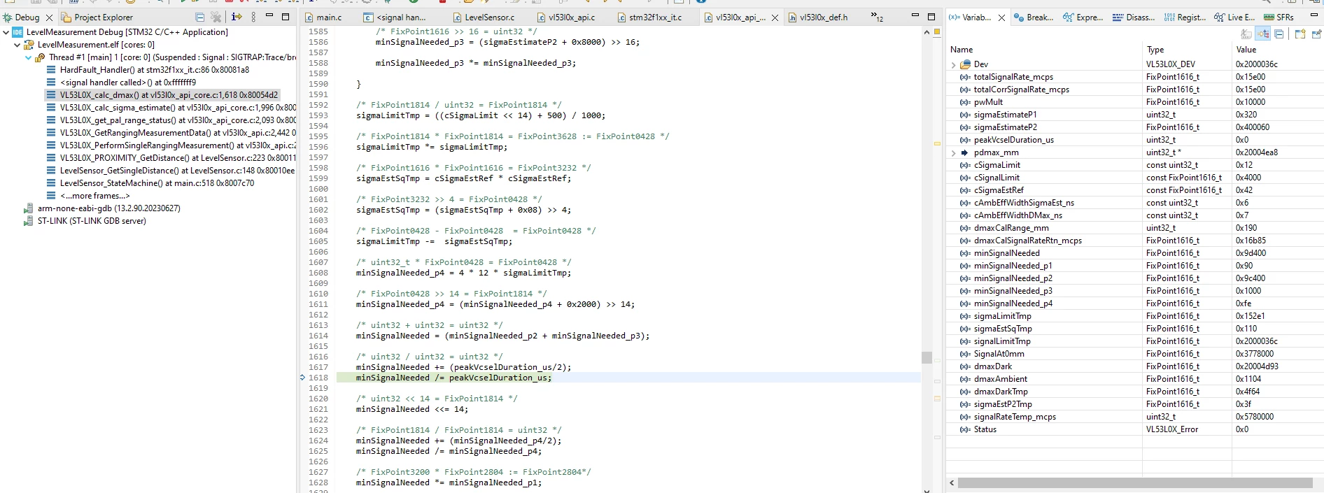

Hello ST Team!
In one of my new projects i use the VL53L0X TOF Sensor to measure simple distances.
The mcu i use is the STM32F103.
To get values from the sensor i use the ST API Library. It's kind of s special version since i use the modified one which is working with the Cube MX Hal.
This is the repository i cloned and pointing to the master branch:
STM32CubeL4/Projects/B-L475E-IOT01A/Applications/Proximity at master · STMicroelectronics/STM32CubeL4 · GitHub
As this project is for the L4 i just replaced the hal include from
#include "stm32l4xx_hal.h" to  #include "stm32f1xx_hal.h"
in the vl53l0x_platform.h file.

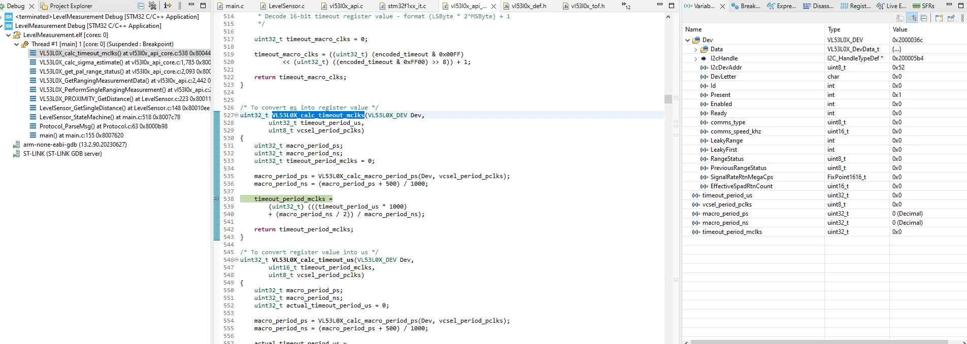

1. The INIT VL53L0X_PROXIMITY_Init() finishes without errors
2. The problem occurs when i do  VL53L0X_PROXIMITY_GetDistance()

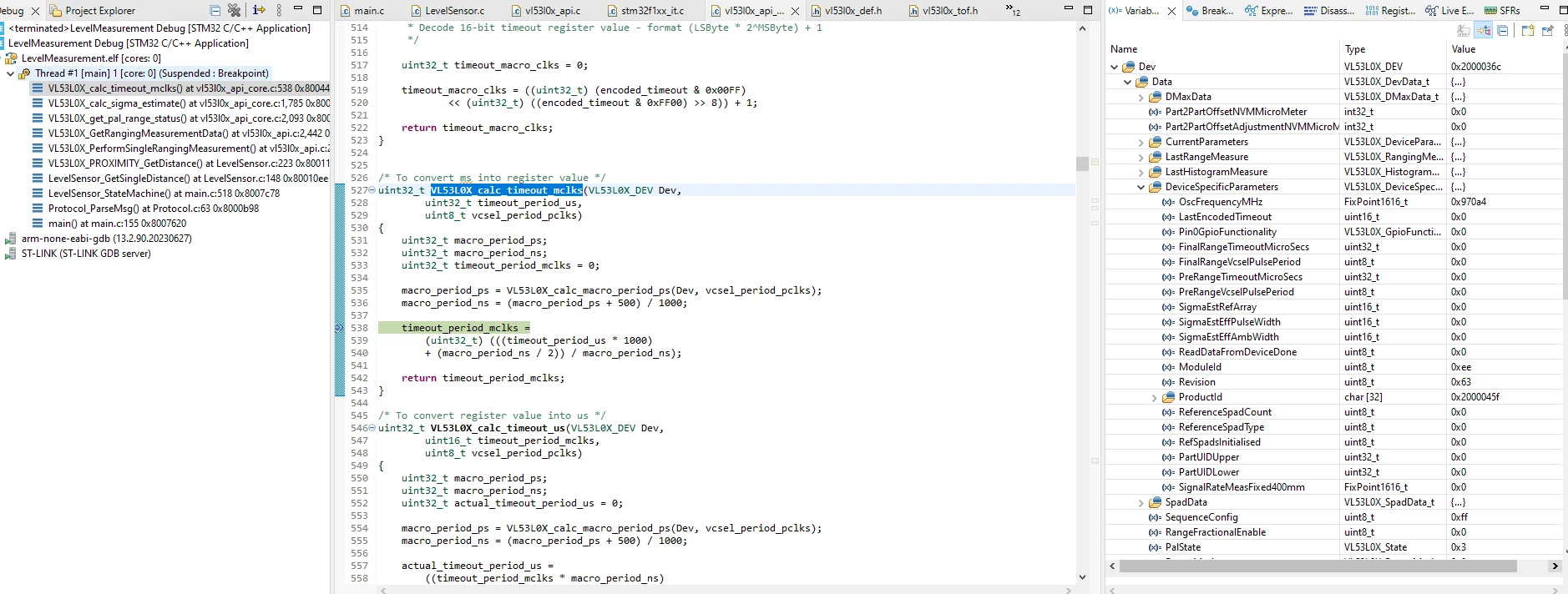

Within the function VL53L0X_calc_timeout_mclks() the division by zero fault occurs and i don't know exactly why since the range measurement is already done correctly.
Following depicts the callstack before the divsion happens.
Additionally the "DeviceSpecificParameters"
If I work around this the next division by zero is following immediatly.
Can you give me some hints why the zero division is happening?
Do i have to set some parameters as mentioned here? : VL53L0X Divide by Zero error in API - STMicroelectronics Community
Problem is that i do not have the VL53L0_i2c_platfform.c platform files.
Thank you in advance!
Regards, Lukas

John E KVAM
April 2, 2025
I doubt yours is the same error. His was a porting error and you are using an STM32, so the timing functions should work.
I will grant you that one really should follow the advice in that issue though.
"...by checking for a zero value (and setting to 1) before doing the (divide)."
But yours is the first mention I've heard of in 4 years, so I'm going to guess it's your configuration.
Although I really can't point to where you might have gone wrong.
Could you post all your sensor initialization calls?
I'm betting there is something amiss in those.
- john
