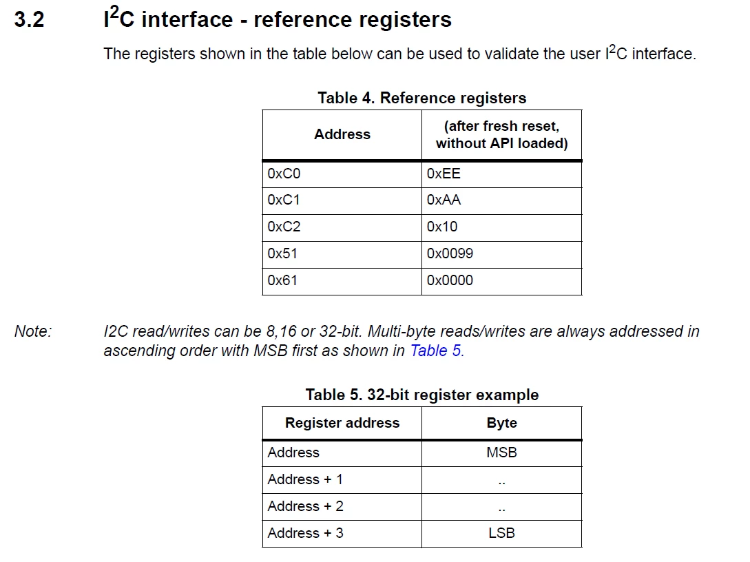

Hi
Your understanding is correct, inside VL53L0X some API I2C read/write function need read more than 4 registers at same time, so it need read_multi and wirte_multi function.
You can find below information form the datasheet, below reg can be used to test the I2C reading function.
Br
