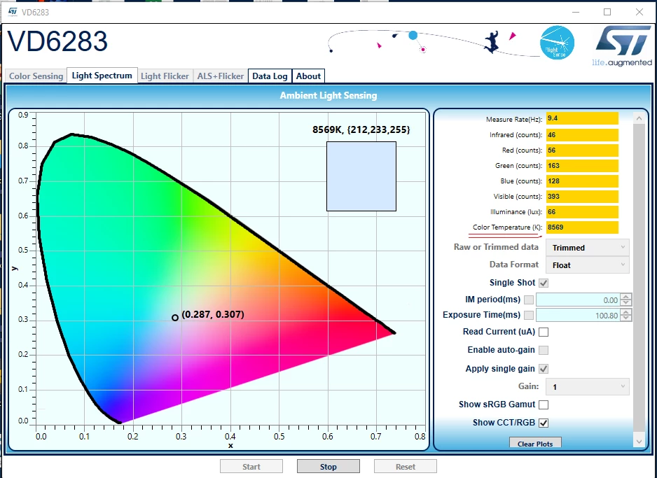

I'm confused. I tested the GUI and got this following..0693W00000JN7qkQAD.pngIs this what you were looking for?
I'm using rev 1.0.0.853, and I'm generally out of lock step with what is currently on the web site, so if you still having trouble, tell me what rev of the GUI you are on.

Yes, this is exactly what I am looking for. I am using rev 1.1.0.862.

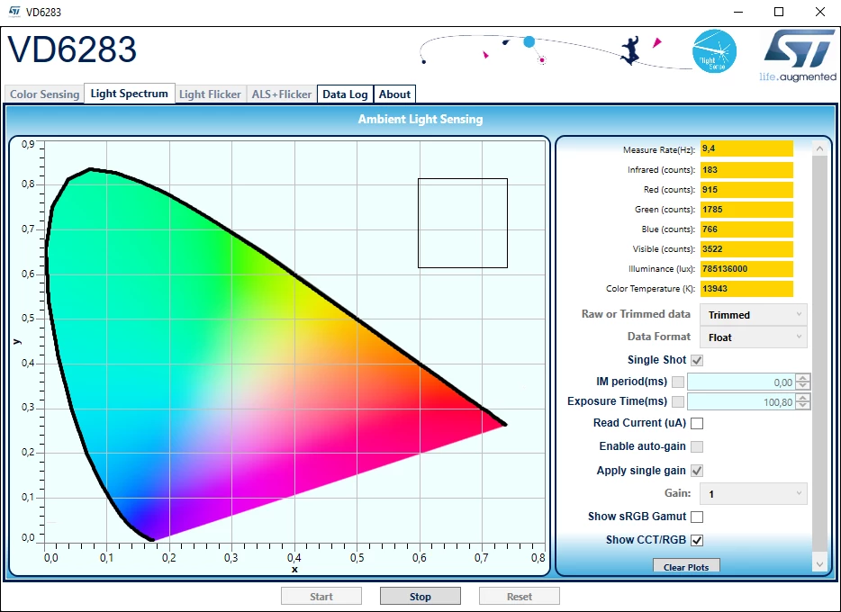

However, in the meantime, I have found out that my problem is probably related to the pretty high lux value :)
0693W00000JNCCVQA5.pngIf I cover the sensor with light absorbing paper all color counts become nearly 0 but the Lux value is still very high. Is my sensor broken or do I need to calibrate anything?0693W00000JNCVwQAP.pngJust in case it matters, I bought the P-NUCLEO-6283A1 evaluation kit.
