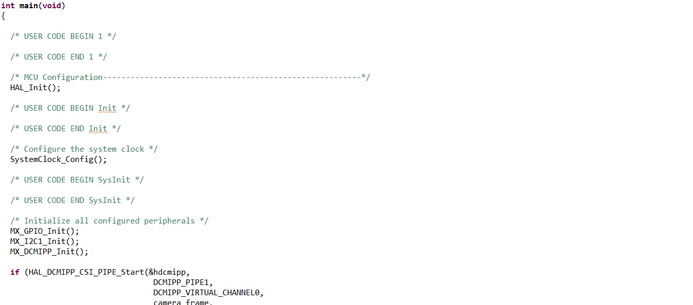

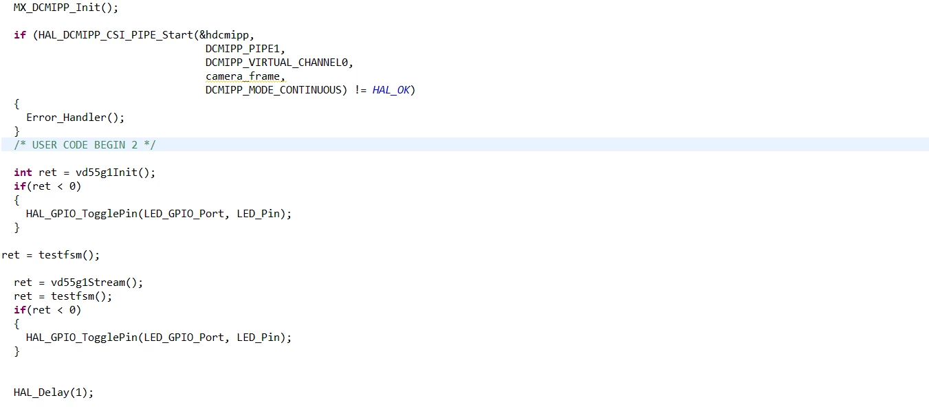

Hi, I'm currently facing a challenge with the VD55G1 driver. I've designed my own minimal system board for the N6 and VD55G1, using MIPI CSI for communication. When attempting to drive the VD55G1, I can enter the stream mode but no data is being transmitted (the N6 interrupt is not triggered). Upon reading the stream_fsm register of the VD55G1, I noticed it remains stuck in the dark task, with the REPEAT_COUNT, CURRENT_CONTEXT, and NEXT_CONTEXT values consistently showing 0 0 1.
Here is my code

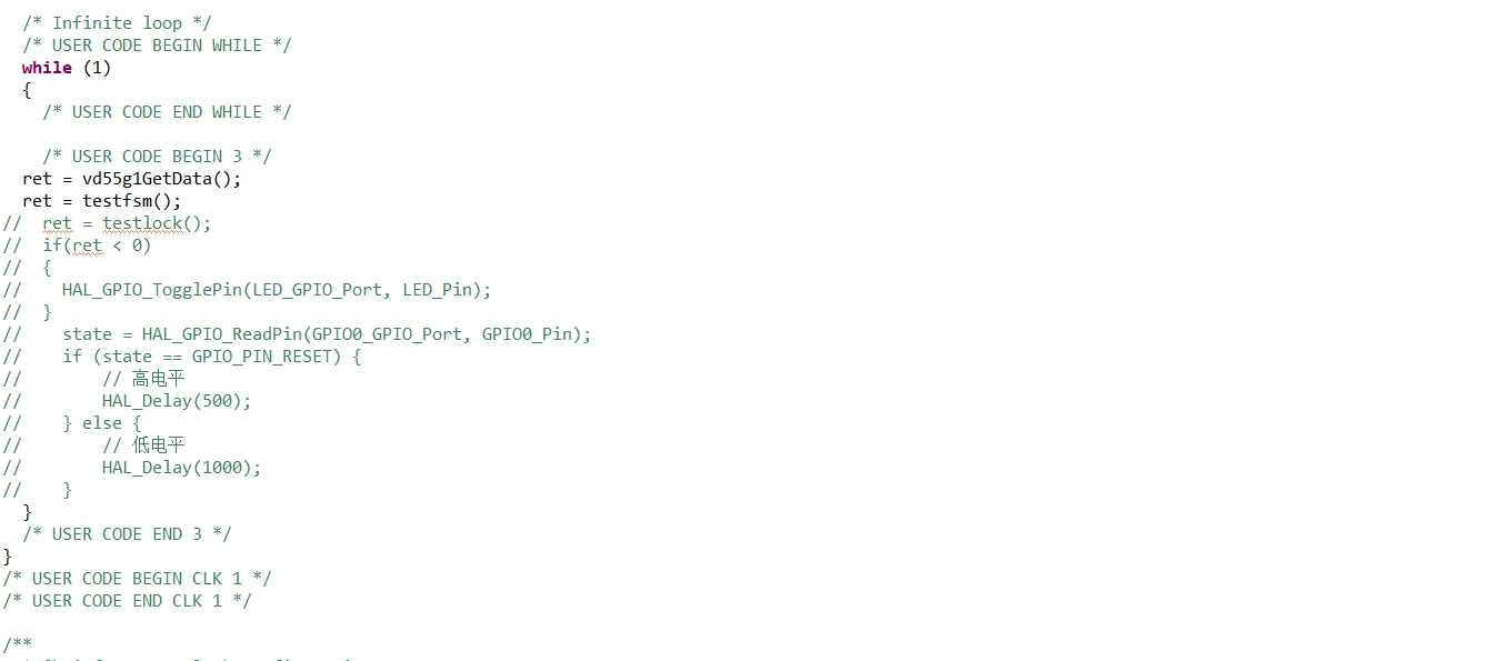

testfsm means getting the value of the stream_fsm register.
I would greatly appreciate your prompt assistance in resolving this issue. Thank you.

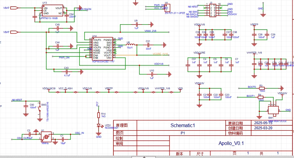

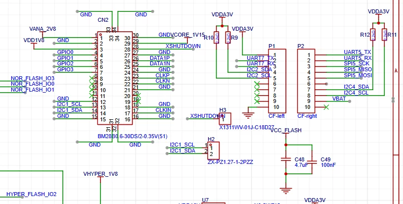

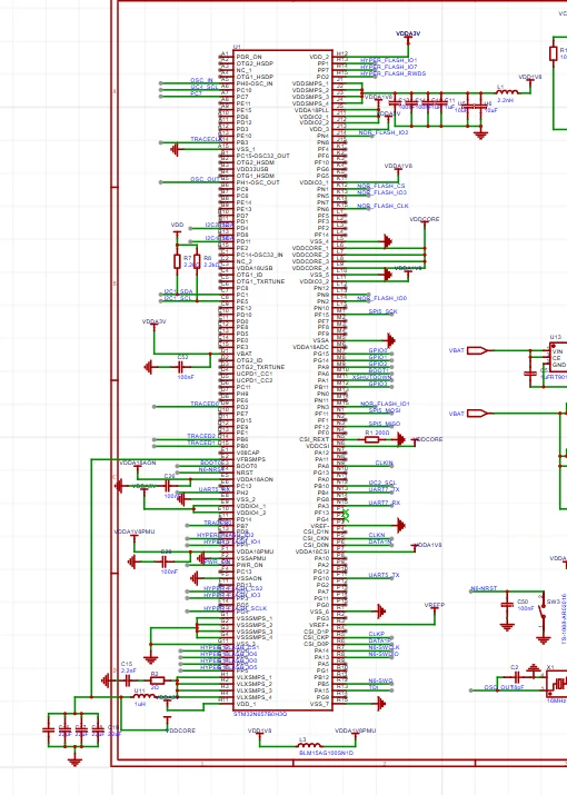

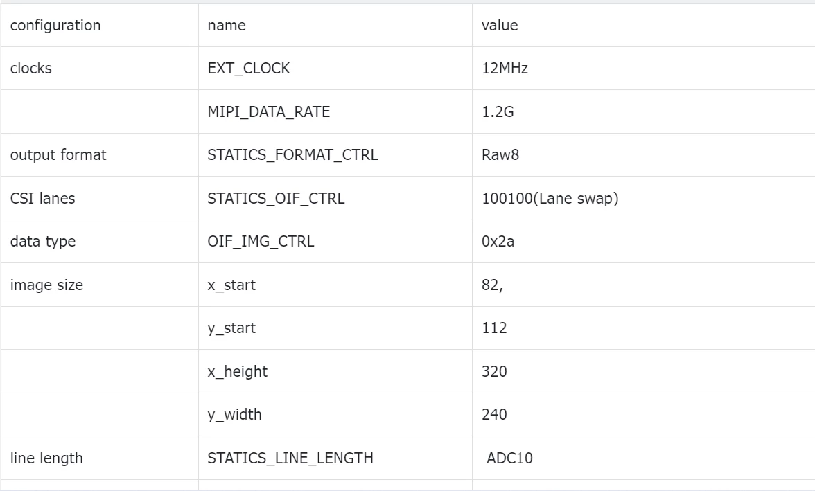

Hi eureka
Difficult to debug like that could be a lot of think.
could you share a bit more information about Hardware and Software :
-Hardware: could you provide clock information and power domain or schematics
-Software : could you share sensor configuration you use.
Thanks in advance
bye
eurekaAuthor
Jul 22, 2025 12:08 PM UTC

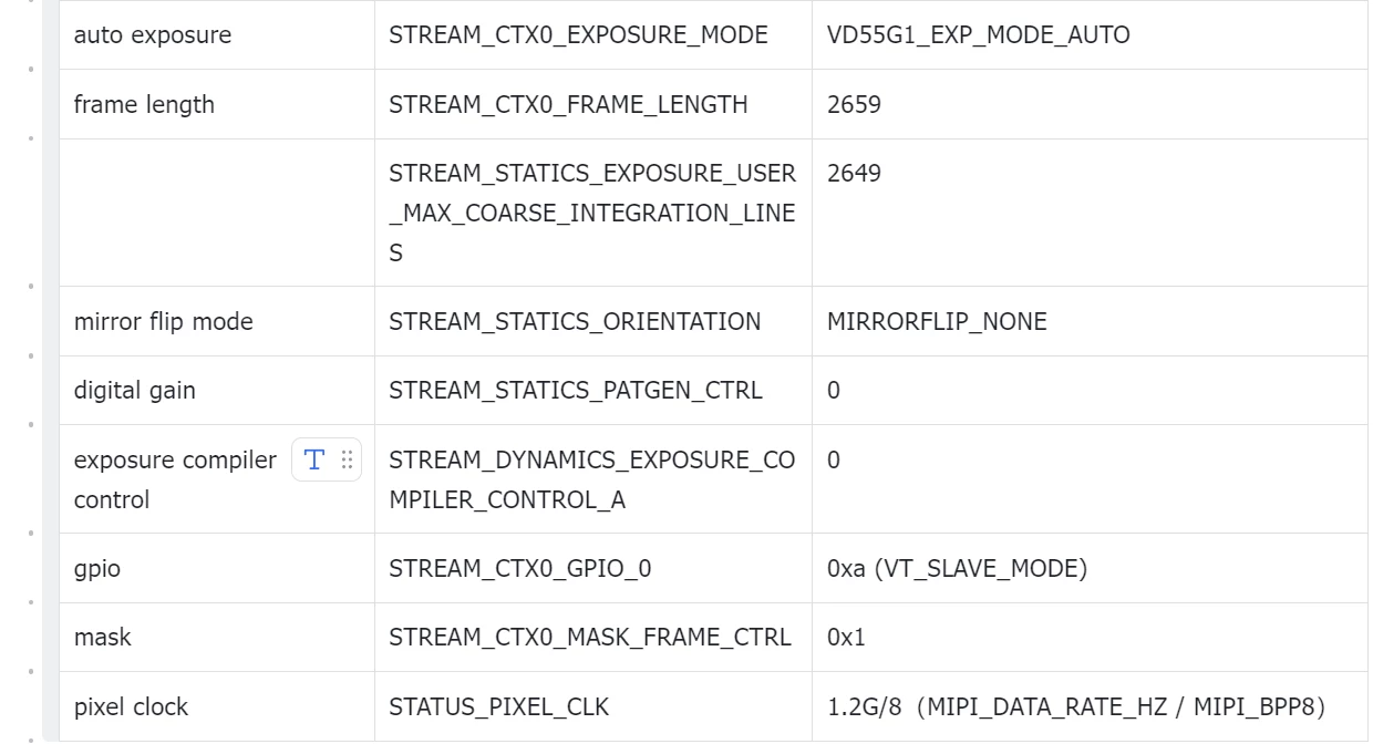

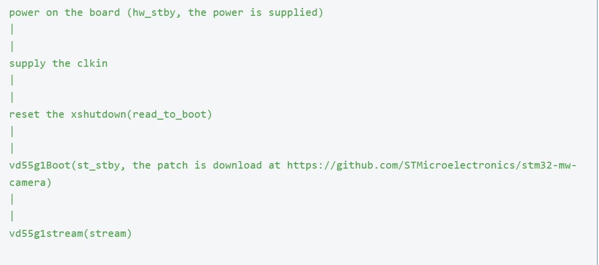

Hello, i am so grateful for your reply.
About hardware:
camera part:
power supply part:
MCU part
About software:
eurekaAuthor

I tried to set GPIO0 to output mode, but there is still no image data whether it is pulled low or high, and the stream_fsm of the camera is in the dark task.
I checked the content of dstaddress in
HAL_StatusTypeDef HAL_DCMIPP_CSI_PIPE_Start(DCMIPP_HandleTypeDef *hdcmipp, uint32_t Pipe, uint32_t VirtualChannel,
                                            uint32_t DstAddress, uint32_t CaptureMode)
but found that it was all empty. Could it be that there is a problem with my detection method?
