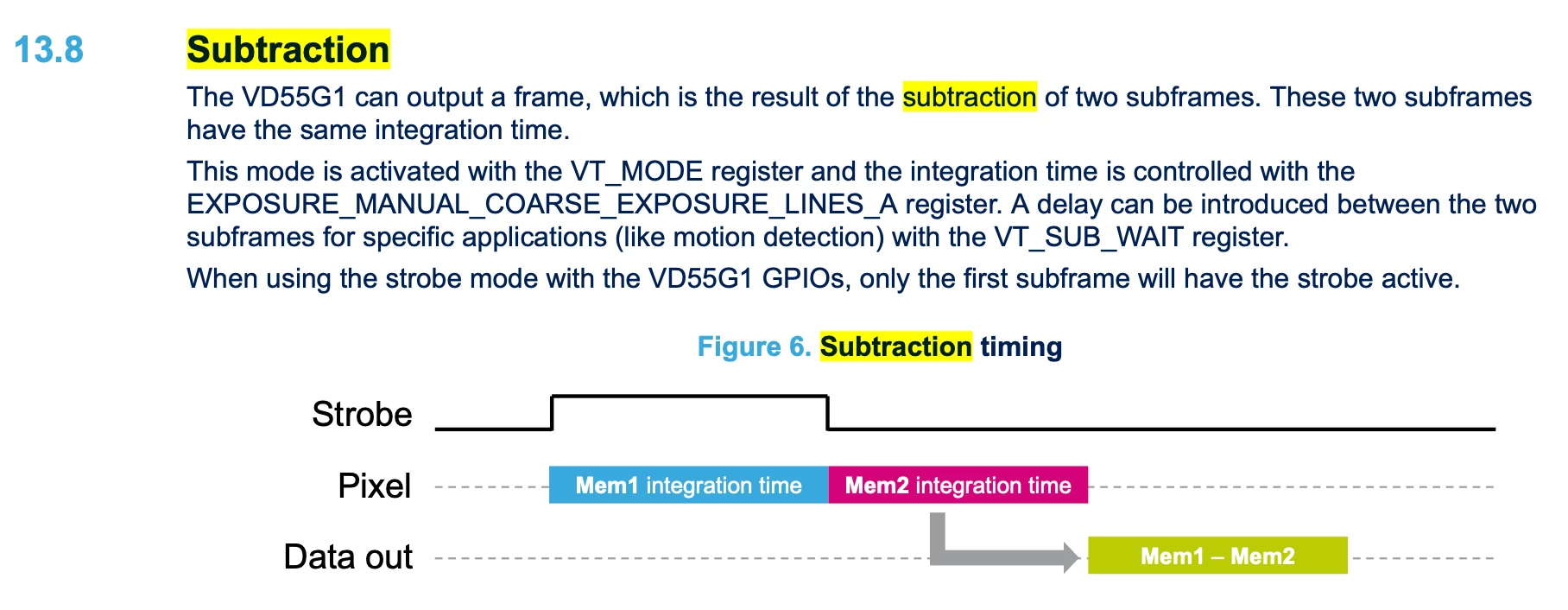

This is the frame subtraction function, which is also explained in Appendices B and C.
The difference between them is that Appendix B requires the host to process the subtraction, while Appendix C performs it on the sensor side. Both appendices also include sample code for your reference.
I have attached the sample code to enable the subtraction for you. For more details, please check the sample code in the appendices.

I guess I made it ambiguous. This is what I'm looking for.
