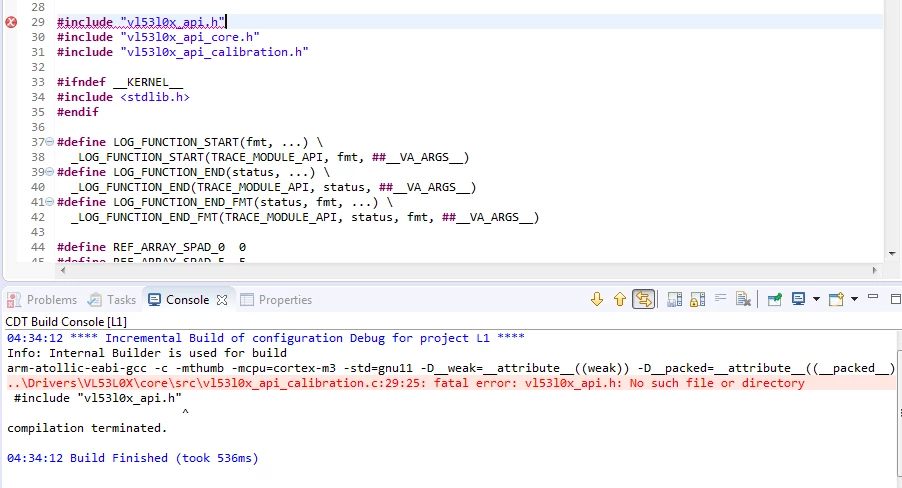

 "fatal error: vl53l0x_api.h: No such file or directory #include "vl53l0x_api.h"
I have included the .h to my main.c but the compilation error jumps from file to file, "vl53l0x_api_core.c", "vl53l0x_api_ranging.c", etc.

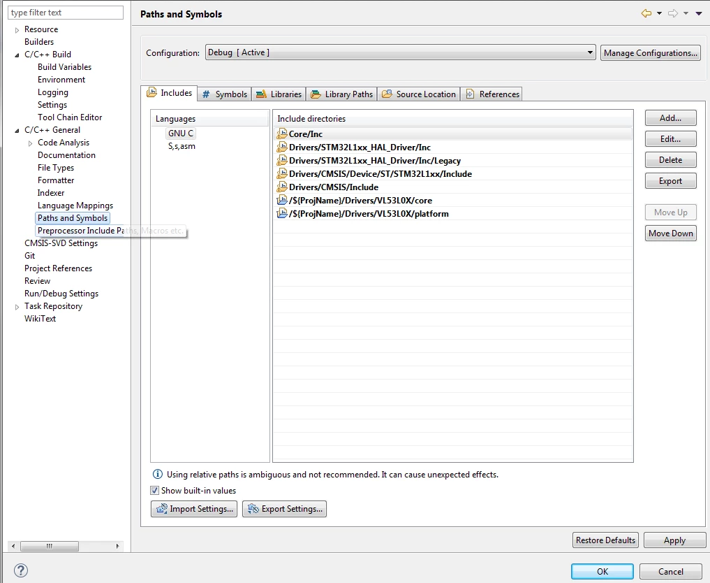

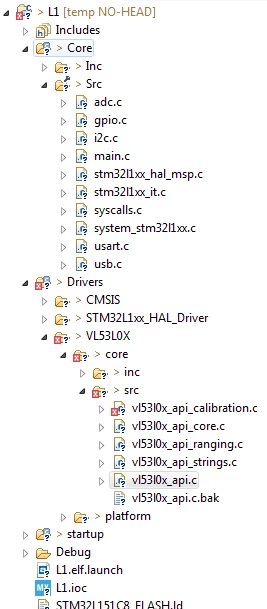

I have checked the build console and all the folders are in the -I directory. Everytime i hit build button the error will jump to another .c file.0690X000009YD5IQAW.png0690X000009YD5DQAW.png0690X000009YD5NQAW.png
