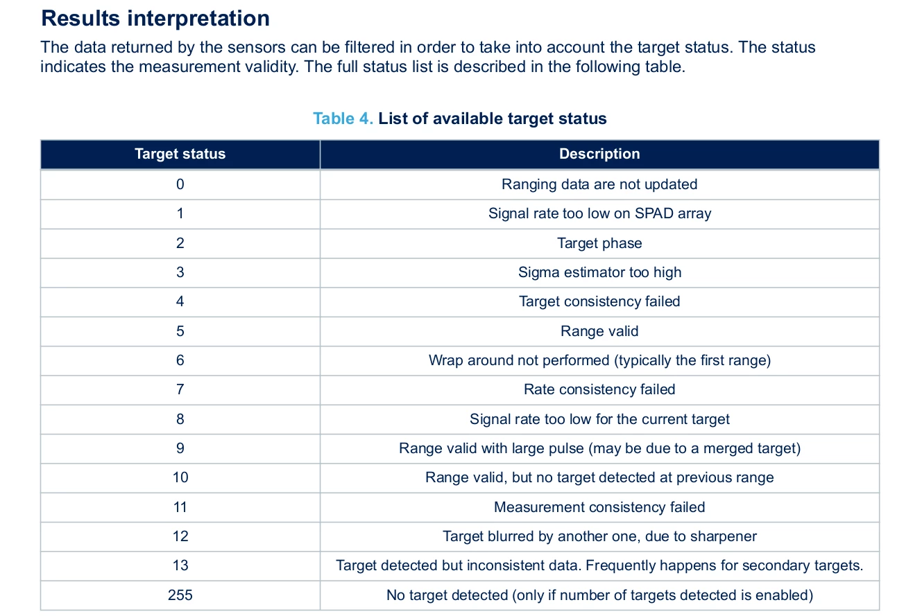

Hello Everyone,
I am currently using the vl53lmz_uld_api  tto process data measured by the VL53L8CX sensor. I have also used the "example_12_cnh_data" to retrieve data from my sensor. However, the incoming data seems completely incorrect, and I don't know where the issue lies. When I hold my sensor 20-25 cm in front of an obstacle, I receive highly unreasonable data:
Zone : 40, Status : 0, Distance : 1383 mm
Zone : 41, Status : 13, Distance : 1892 mm
Zone : 42, Status : 5, Distance : 1371 mm
Zone : 43, Status : 5, Distance : 1367 mm
Zone : 44, Status : 5, Distance : 1347 mm
Zone : 45, Status : 5, Distance : 1370 mm
Zone : 46, Status : 5, Distance : 2448 mm
Zone : 47, Status : 9, Distance : 2262 mm
Zone : 48, Status : 4, Distance : 2977 mm
Zone : 49, Status : 0, Distance : 1398 mm
Zone : 50, Status : 5, Distance : 1381 mm
Can someone please help me to understand what i am doing wrong  here is my main.c:

Best answer by RogerM
As John says for now just look at zones which have status == 5.
With regards the range data you are printing out.... in the platform.h file do you have the following line active or commented out?
      #define VL53LMZ_USE_RAW_FORMAT
If this is present the driver returns the raw range value which includes 2 fractional bits ...which means the raw value must be divided by 4 to get the actual range in mm.
Please look at the code within vl53lmz_get_ranging_data() which is conditional on the VL53LMZ_USE_RAW_FORMAT define.   Depending on if this is defined or not it either does, or does not,  convert from "raw" to real values.

John E KVAM
April 14, 2025
you need one other thing in your printout.
The algo for knowing you have a target is:
if Number_of_targets > 0 AND the target status is either 5, 6, or 9, THEN you have a target.
The return array is NOT cleared before ranging, so there is potentially a lot of junk in it.
Now if you are still not getting good data, we have a problem.
One test is to use a white sheet of paper. Hold that at 30cm or so. A nice reflective target should give you great results.
An object as small as your hand should range to about 60 or 70cm, then there are not enough photons returning.
If that is not giving you good results, give us a picture of your project, maybe I can see something.
Do you have coverglass that is not optically clear? Do you have any structure in the way?
There is something wrong with the physical setup.
- john

Hallo  @John E KVAM ,
Thanks for your help. Unfortunately, your suggestions didn’t resolve the issue, and  marking the post as “solution” was a mistake.
To clarify:
  • I don’t have any cover glass or physical obstruction in front of the sensor.
  • The sensor is consistently returning a status of "5", but I’m getting wrong or unreliable distance data.
  • I also can’t access the nb_target_detected field in VL53LMZ_ResultsData, even though I have disabled the VL53LMZ_DISABLE_NB_TARGET_DETECTED macro in my platform.h.
At this point, I’m a bit stuck, so I’ll post my full main.c below for context  maybe I’m missing something obvious. Any help is much appreciated!

Only use the distance value when target_status == 0. ( Edit - Should be 5, not 0 - John Kvam)
if (Results.target_status[VL53LMZ_NB_TARGET_PER_ZONE * i] == 0) { // Edit again should be 5 not zero
printf("Zone : %3d, Status : %3u, Distance : %4d mm\n", i,
Results.target_status[VL53LMZ_NB_TARGET_PER_ZONE * i],
Results.distance_mm[VL53LMZ_NB_TARGET_PER_ZONE * i]);
(Edit) Technically a status of 5 is vaild, 6 is first time (and likely valid) and 9 is a merged target (which could also be valid). But these others are kind of rare, so some people only allow 5 as a good range. - John
